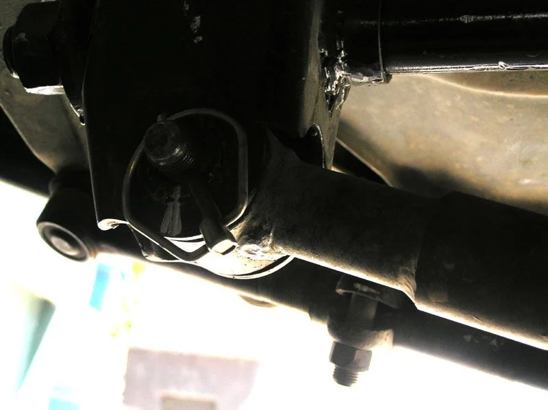

Clownmidget had issues with the front panhard. The upper bolt came loose and fell off. He was able to do a trail fix. But when he got off the trail, he notice a crack all around the upper front panhard bracket weld.
I told him to look for it, since I had a crack on the same weld a couple of years ago.
If you wheel your 80 hard, keep an eye on the front upper panhard bracket weld. As far as the sector shaft, I would change prophylactally.

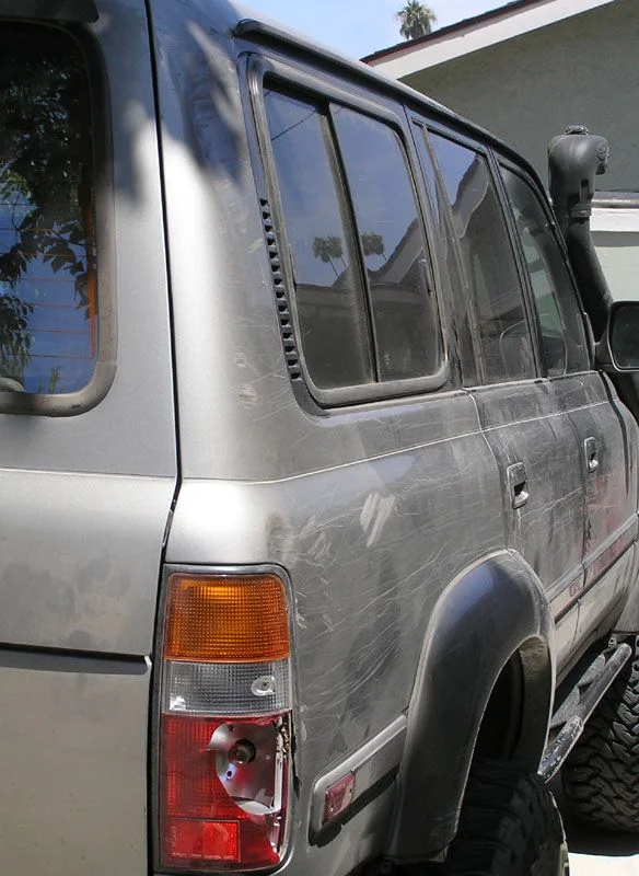

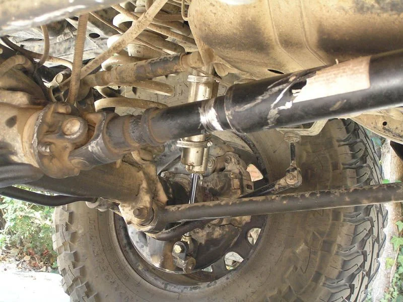

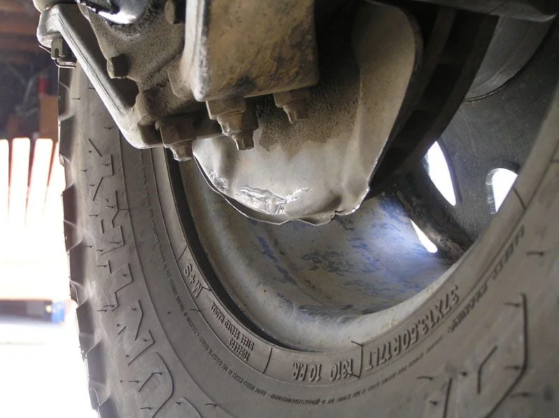

carnage
both rear corners got tagged. PS up onto the pillar.
rear driveshaft while ignoring 7 spotters
dropping front discs onto rocks repeatedly...

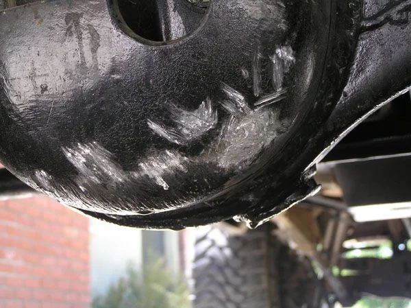

more
hit front diff so many times the top 5-6 nuts holding the third member on came loose and I lost the gasket.
both upper and lower front panhard bolts tried to leave
upper front panhard bracket cracked completely off at that weld repair line.
Wow, Mike--In your last picture, you can even see the splines on your sector shaft are twisted!
Anyway, the sector shaft issue is a major one. With that broken, there is no way to steer the truck, even to get off the trail. I don't know if they are particularly weak on an 80 series, but I have seen others post about broken and bent ones.
Anyway, this was an all time great trip. The group pulled together very well when the chips were down. I never thought the field fix of welding the shaft would hold, but it did-Kudos to Rick.

Yep-Not only a busted door handle, but a big ass scratch in the paint on my front diff hat!

Here is a pic of where Mike striped his driveshaft, all the guys that drove were amazing. It is the most difficult trail I have ever seen a wagon go thru.

Originally Posted by clownmidget View Post
dude, the sway bars were completely removed before the truck touched the trail. they were used for the 300 mile drive to and back...
Ahhh...didn't know you had quick dis on the panhard also... Thats what is shown in the pic.
