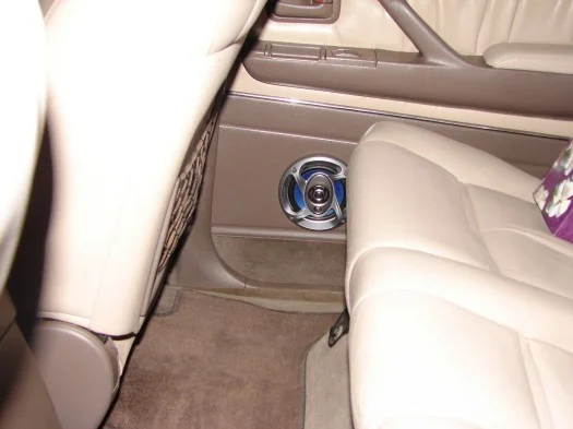

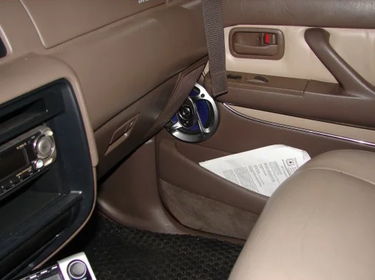

Heres one for you... When my stereo guy installed my system, he removed the original speaker grills and mounted the Pioneer grills from the outside. This enabled the rear speakers to be 51/4 from the original 4". He had to drill new holes in the rear door sheet metal to secure the speakers and that made it rattle free as well. The fronts are 61/2 and the dash speakers are 4" coaxials. Truly enhanced the sound factor. New deck, amp, and 8" kicker in a tube. Enclosed some pics to show what I mean. I agree with the above, for the money, the Pioneer sound is fantastic. You dont notice until they are changed that what youve been listening to was weak!

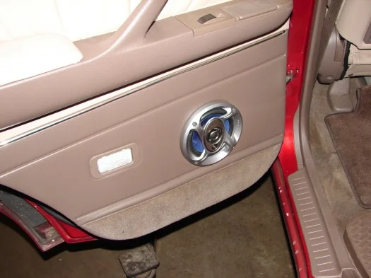

here is a picture of the drivers door open...

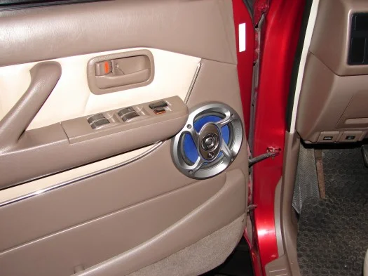

sorry, that previous picture was the drivers rear door - here is the drivers front door...

Keith, sounds like your going to have to use the Eclipse model for your 97'. I have the Eclipse model on my 1995 and they fit perfectly with my stock grill. I don't recall the model number...but I believe it was mentioned in this earlier thread above.
