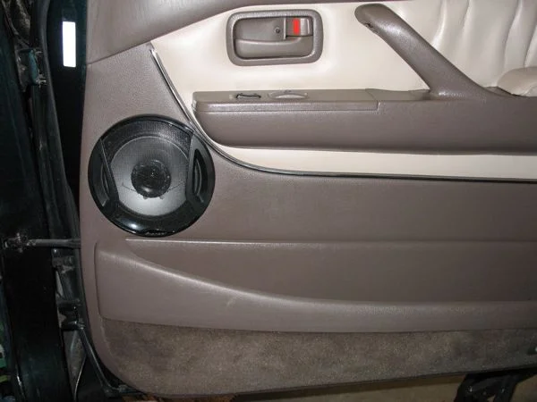

My '97 had the same issue Keith described. I think the OEM speaker grill must be smaller because the Pioneer TS-G1641R would not clear the the plastic mounting tabs on the factory grills. But the cutout in the door panel is 5", and this is the exact size needed for the 6.5" Pioneer's. So like Ted described in Skillet's original thread on the Pioneer's, I too removed the factory grills and mounted the front speakers directly to the door panel. The existing mounting holes in the panel like up perfectly with the mounting holes in the speakers and new grills, so no drilling is required. I also mounted a square of Dynamat Extreme on the rear side of the door panel to help acoustically seal the speaker in the door. And as suggested in other speaker threads, I disconnected the two front dash tweeter speakers since they contribute little to the sound and just draw power from the amp.
When I removed the driver's side speaker I discovered two large sections of the cloth surround were completely missing. Water must have gotten in there when the PO had the vehicle and over time the material just rotted away. No wonder the old set up sounded so bad!
The Pioneer TS-G1041R install in the rear doors of my '97 just like others have described, so no changes there.
Even with the stock head unit, these new speakers sound great to my old ears. I added an Anaba FM modulator at the same time so I can connect in my iPod. Not as nice as a direct connection, but that option isn't available with the Toyota head unit and this was the next best thing. (Definitely better than a FM transmitter, and I found it to also be better than a cassette adapter.) Update: I've now gone back to the cassette adapter for my iPod/iPhone; the FM modulator had subtle sound quality issues. Also, the Pro.Fit miGrip (Pro Fit miGrip and miniGrip Universal Holders) combined with the LoBoy (Pro Fit LoBoy Mount for hand held electronics) makes for a nice mounting system for the iPod/iPhone.
So for $100 or so and a couple of hours of work, this upgrade yields a high-value return.
Here's a picture of what the grill looks like on the front door:

Quote:
Originally Posted by citadel View Post
anyone have speakers fit the stock location with the stock speaker grill for a 97 yet?
At least a couple dozen of us.
You'll need to space the 6.5 Pioneer speaker out about 1/4" on the fronts, and 4" speakers will fit fine in the rear. Stock speaker grill fits both.
__________________

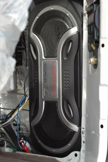

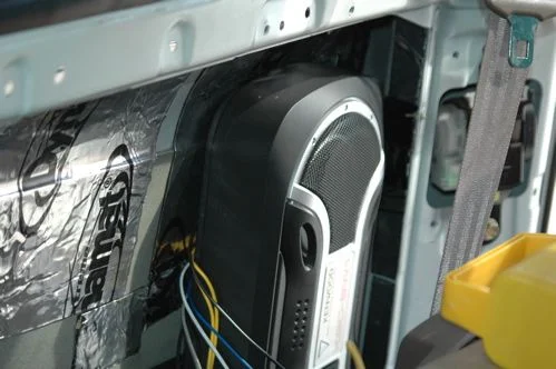

Check on my thread on the stock mounted sub. You could easily stick with stock sized fronts and add the sub for an outstanding system.
The new receiver will make as much or more of a difference than the speakers. My system is flat out unbelievable compared to what it was a week ago, and I'm just running a Pioneer deck and Kenwood speakers.
we you able to get the stock speaker grills to mount back flush with the door panel?
Yes Curtis,
My stock speaker grills mounted back with no problem.
You can not see any bulge in the door panel at all with mine. I only had to shim the speaker out about 3/16" on mine.
__________________
