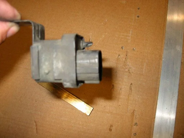

The Fuel Pump Relay (FPR) is located on the driver side of the car, just forward of the fuel pump resistor. It's attached to the fender, and the body of the relay is inside the fender itself.
Here are the pics of the location. It is held onto the fender using a 12mm head self tapping screw.

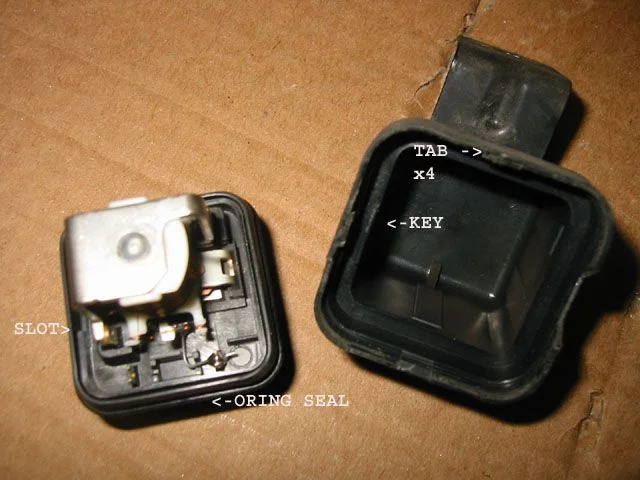

Once removed, you will need to separate the top from the bottom. To do this, you turn the relay bottom side up, insert 2 screwdrivers 90 degrees apart and spread the 4 tabs out while pulling on the top box. It's a bit tricky, and you can see from my photo that one of the tabs popped (brittle from age). Not a big deal as long as the oring will still seal against the box when you open it up. The trick is to pull apart the 2 pieces while just getting the tabs to clear the bottom board. Do note there is a key and socket to orient the 2 pieces of the relay. This means the relay top can only go in 1 way to the bottom board.

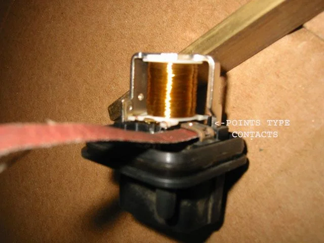

The relay works as follows: When not powered from the ECU (idle), the fuel pump power travels thru the Fuel Pump Resistor. When powered, the wire wound magnet gets power, closes the contacts (points type) and 12 volts is fed directly to the downstream side of the Fuel Pump Resistor. The problem with points type switches, is that they get pitted.
In picture 2, you can see where I inserted fine sand paper into the gap in the points and cleaned the contact pucks. RT used a matchbook striker which is a great idea. It's key NOT to bend the contacts in any way, or there is a good chance the relay will no longer work (outside the field of the magnet). You need to clean the bottom contact puck *and* the top contact puck.
Once done, orient the key in the top cover to the slot in the bottom board, and press together until the 4 tabs clip over the bottom board. Make sure the oring is not deformed, missing or cracked. If so, you will need to use RTV or some sealant against moisture.
