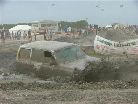

Mate, your just going to have to do it! And take lots of pics.
No matter what you drive, your not going to beet ppl who have a bigger budget and dont have to drive home!
I like low range cause it gives me more gears(manual).
I have a spare, race only altinator, and de-gas the A/C and pull the condenser - makes washing out the radiator easier. Sponsorship helps here- dont be afraid to ask.
Plenty of duct tape, grease and wd40 to waterproof things and your good to go.
Have fun
Matt
edit - the 70srs in my avitar pic is my old comp truck - but coils beets grunt!
