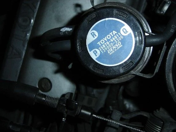

Ah, yes...the most common issue with our beloved Cruisers. You'd do yourself good to buy the Factory Service Manual and flow through the trouble-shooting steps for the VSV (Vacuum Switching Valve) that is located UNDER the upper intake manifold. I suggest testing this BEFORE wrenching anything because it may not be your problem.
I also recommend checking and verifying all the little rubber hoses and pass throughs that control the EGR itself.
In the long run, that little FSM will save you a lot of grief for sure and will keep you from a lot of parts swapping as long as you RTFM.
By the by, what color is your modulator? There were two models of that and it superseded. The best way I know to tell which one you've got is by the color of the stick on the top. I don't think they fail very often though.

Pics of modulator and VSV:
EGR Modulator

Blue modulator
pics:
