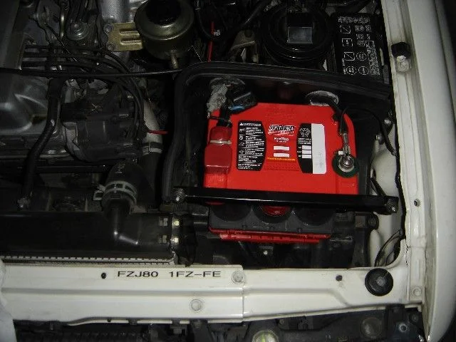

Man, I hope my optima red top holds up! I got it at costco. They said i could return it if it fails within the 3 year warantee.
