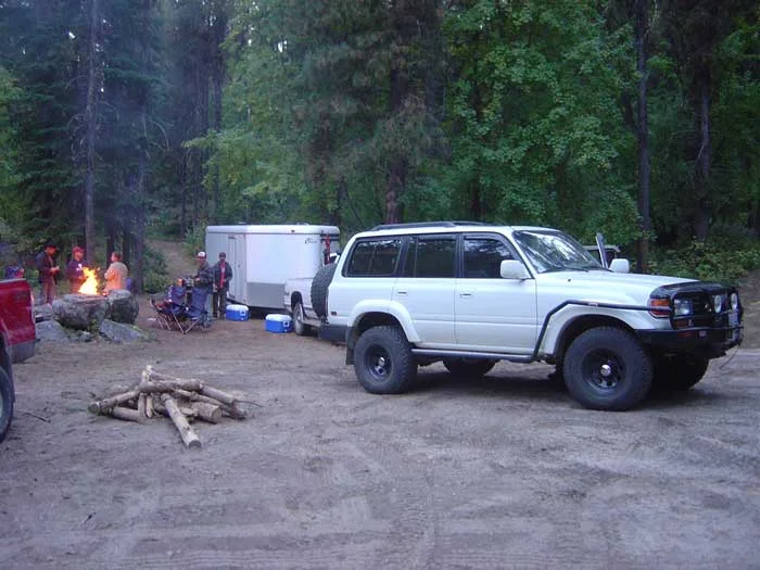

Question OME Lift ?'s - Modifying existing lift... YES I've been searching...
Hey all,
Been doing a lot of research on this and wanted to run my conclusions by you guys to see if I'm on the right page. The hard thing is that I bought the rig with the current lift on it, so I don't really have any measurements to compare before and after ride heights.
Current Suspension Setup:
OME 2.5" Lift + Caster Correction Kit (Purchased from MaF back in '01)
Front - OME 851 + 10mm Packer + N70 Shocks + Heavy Duty Swaybar
Rear - OME 863 + 10mm Packer + N71 Shocks + Heavy Duty Swaybar
BFG AT 295/75/16's
Cargo / Weight:
Front - ARB + Sidebars + Winch + Dual Batt + Turbo junk
Back - Kaymar + Spare + Jerry Can + Hi-Lift + Aussie Drawers + Gear
Impressions:
Rides better than I could ever hope for, super smooth over wash boards, corners great. Doesn't seem to sit as high as a 2.5" should (check out pic below), guessing that's due to a loooot of added weight. I also have a bottoming out problem when hitting bumps in the dunes. Just overall doesn't have the clearance I'm looking for. I do plan on keeping the current tires for a couple more years, and am not opposed to 35's when they need replaced.
Now I know that my current front springs are rated at 2.5" assuming 0-110lbs which I'm sure I'm over, and my rears are rated at 2.5" assuming 200-440lbs, which I'm guessing I'm in the ball park. Even with added tongue weight when towing I'm pretty happy with the limited rear end sag.
Lift Plans:
I think I'm going to start with the fronts so I don't get ahead of myself trying to keep her level.
Front - Ditch the packers, go with 850J's and 2" poly bump stops.
Back - 2" Poly bump stops, and hopefully be able to level her out with spacers or packers. Additionally I may move the Hi-Lift to the front due to departure angle issues... That's gotta help shift some weight.
Dilemas:
I'd like to keep the current shocks, are the J's going to be too long for them (354-614)?
Will my current caster correction kit keep me in spec? I'm assuming the J's will still settle a little and put me in the 3" range once I ditch the current packers.
Any other pit falls you can see?
Thanks!
(I'll try to dig up a better pic on more level ground.)
