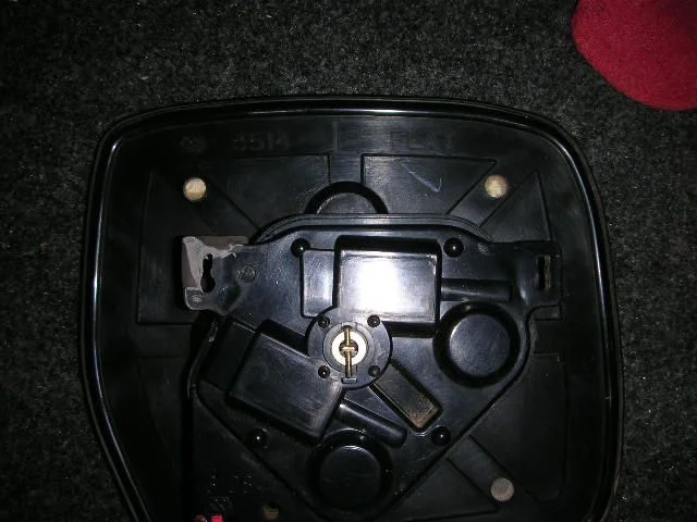

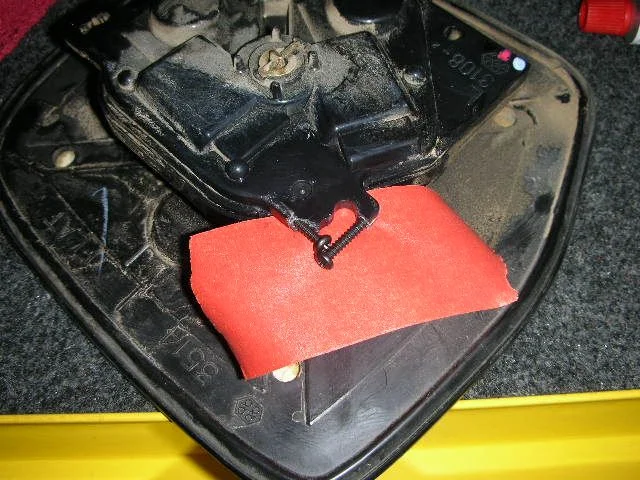

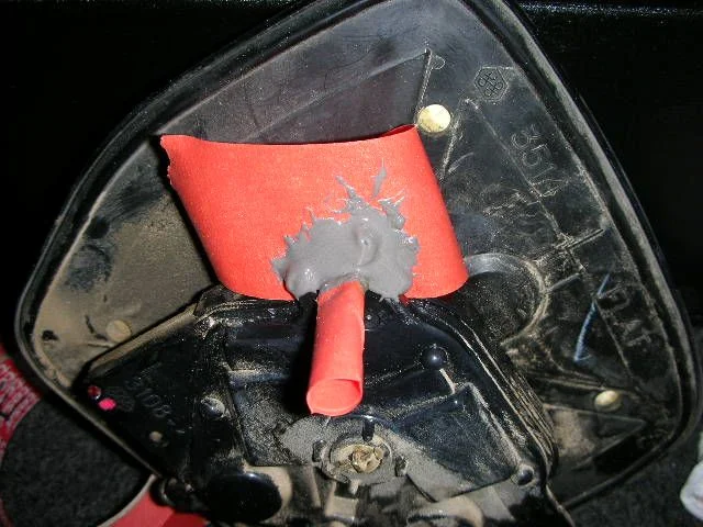

Epoxy might be a better choice than super glue. I recently repaired mine with some JB weld and a couple of #4 screws. Just remove the bottom screw and remove the mirror ( keep track of the wires as they're all seperate) then simulate what the factory did with the epoxy instead. I can't seem to find a pic right now but I'll continue to look.

Found 'em:
Quote:
Originally Posted by 619TOY View Post
Found 'em:
I just did this to my mirror on Friday. Does anyone have any data regarding how long the jb weld holds? I am just curious.

If you used the screws as well, it should last quite a while. Mine is still fine after many, many off road trips including Moab and the Rubicon.
