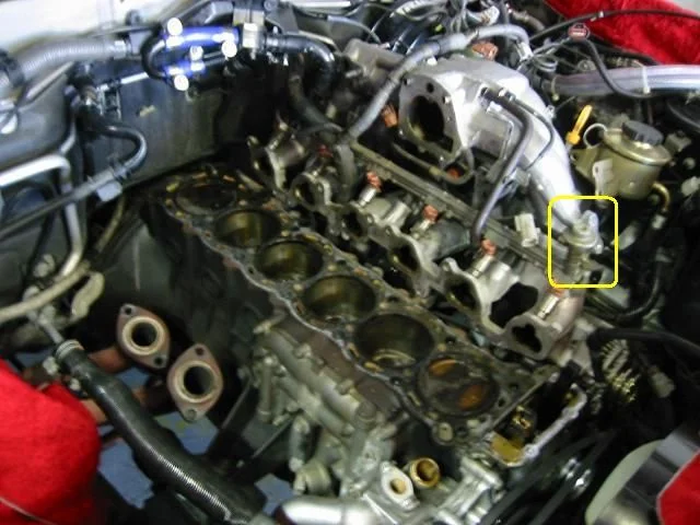

If you already know then forget it, replace the fuel pressure regulator also while you in there.
