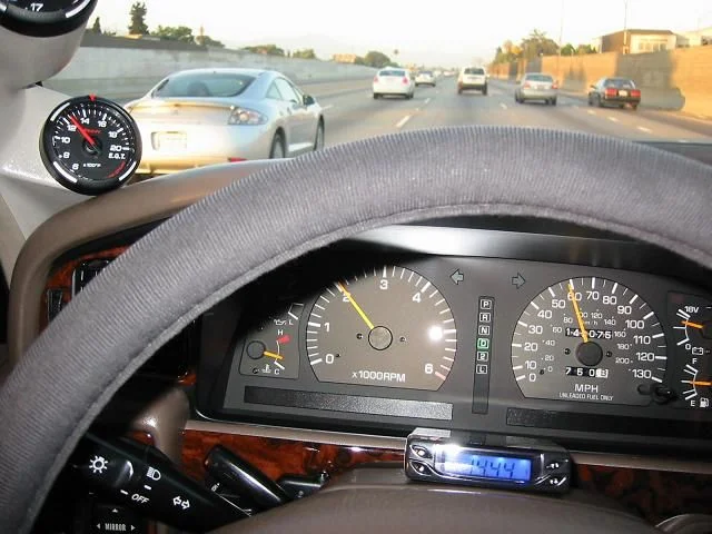

Stock gasser (non turbo) driving 60 mph on the freeway/ highway my EGT gauge reads about 1250.
LX_TREME is offline   Reply With Quote

Quote:
You can see here at this pic time I was runnign about 60mph
I have no pics of my EGT before Turbo, but are far way up, like 200ºF more .. atl east.
