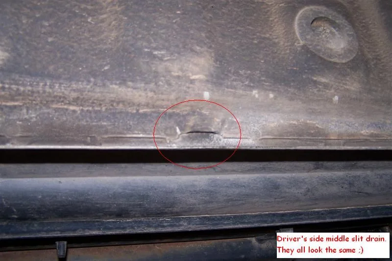

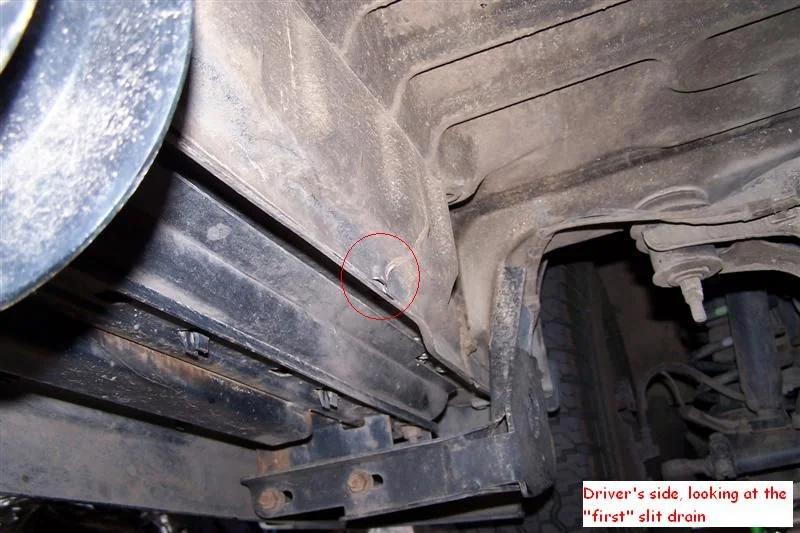

It got there via the forward sunroof drain hoses. It's stuck there because the slit drains in the bottom of the pinch-weld are plugged up.
The quick fix is to pull the forward rocker plugs. You can use a zip tie to clean the slit drains out.

Look at the bottom of the rocker. You will see a round plastic plug about a foot back from the front edge of the rocker. Pop that out (careful about that so you don't get yer Saturday night bath early.. ). That will solve your immidate problem.
The slits are a bit harder to locate.
Get on your back and study the back side of the pinchweld wher the inner and outer rockers come togther. About a foot back from the font edge you will see a slit, near the bottom edge, that is on the inner vertical surface. You can use a zip tie, as you would a rifle cleaning rod, to clear the drain.

So do the slits look like a little half moon just above the seal? Three to a side right? Front PS will be a PITA to get to well with the cat protector on the sliders. Pulled the front most rubber plug. Not much. Do all three plugs come out? The back two are a different style. Tried a super small wire, but it just wanted to bend. Will try the zip tie next weekend.

I just pulled the front plugs on both sides, no plans to put them back or figure out how to clean the slits. Lots of water came out of both when I removed them. Good idea to test your tubes down from the moonroof by (bravely) pouring water over the (closed!) glass. The water should almost immediately come out the drain plug.

Quote:
I've seen many threads/posts mention the "Drain Slits" or "Slit Drains" but never a picture of what they look like. With the right description (like above) it is pretty obvious what you are looking for but for those that like pictures (like me) here are a couple pictures of what these drains look like. There are 3 per side and the DS ones are the easiest to get to (i.e. no cats/exhaust)...
