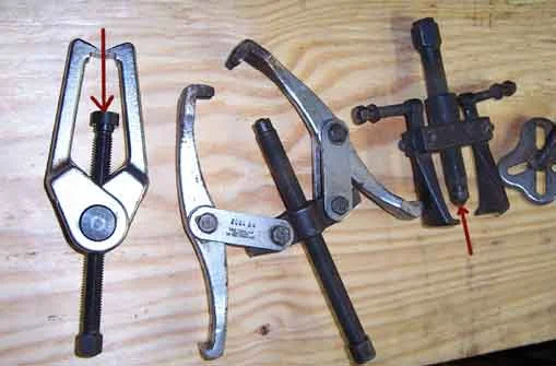

I have these pullers, need to do all rod ends and stabilizer on one truck so far. I've destroyed 2-arm pullers before, this Craftsman seems fairly sturdy. The tie rod puller is too big, I see big & small at Harbor Freight, so I need the small? I inherited this one, Oldforge #2507, it has a Carquest price tag of $23.85 on it, and I'm sure that's years ago. Harbor Freight has these pullers for $6 & $8, am I looking at the same tool? That's a pretty huge difference for such a crude tool.
Klunky Chris recommended this tool, where do I get it and how much? (18th post) http://forum.ih8mud.com/showthread.p...3&page=1&pp=30 And how much better does it work?

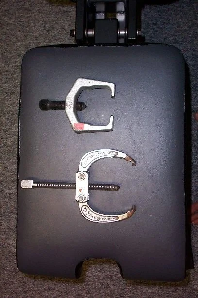

I believe the ends for the tie rod pullers are made with a cup like deal (first on left in pic) to go over the threaded stud of the tie rod end. Pitman pullers have a pointed end I think.
Bill
