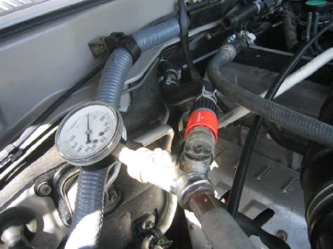

here they are....
This shows the arrangement for heaters backflushing. Used garden hose thread to 5/8" hose insert adapters.
The feeding hose goes into the heaters outlet (it's the hose with the orange quick-disconnect and the pressure gauge). The collection hose goes into the heaters inlet (the plain gray hose).
Note the water does not get to any other place in the system so this arrangement is best if you want to maximize flow through the heaters and check to see if any sludge comes out.

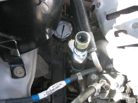

Cleaned my cooling system: the full scoop...
This shows the manifold in place for rad backflushing. It's put in the rad hose right next to the thermostat housing.

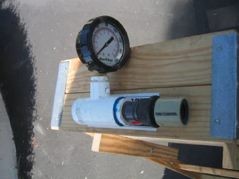

photo 3
this is the manifold I made for rad backflushing. The part connecting to the hose is the straight part on the left of the 1" PVC Tee. It fits just fine in the big rad hose. I connected a garden hose on the other end of the manifold with a quick-disconnect.

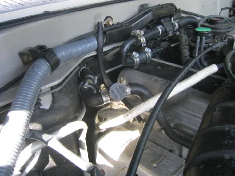

this is the final arrangement with the Prestone Tee to hose adapter in the heaters outlet hose. Easy for flushing the block. Note for those of you up North, this will obstruct the flow a tad so may reduce the flow through the heaters. But I'm still cranking out air at 150F through the dash, so that'd be enough for California I think...
Also: Warning! if that thing ever leaks seriously, you may be out an engine, so caution is suggested.
