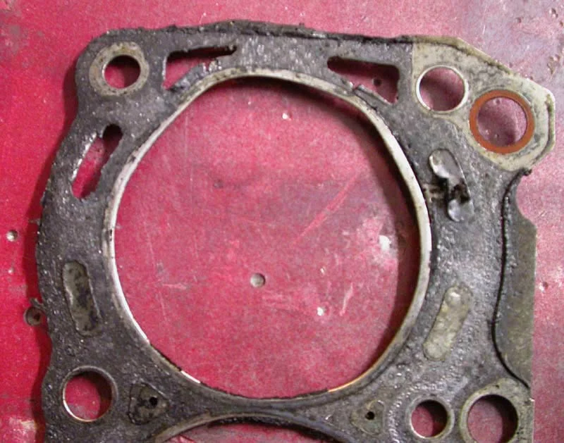

From the look of the gasket pic- it looks like they used the older style gasket as a template versus the newer. I thought the newer template had circular holes near number 6 which gave more space.(?)

round holes are stronger and gave more support for the cylinder ring, in the original setup it was unsupported and could blow out into this void.
