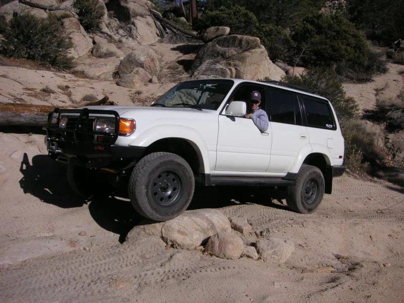

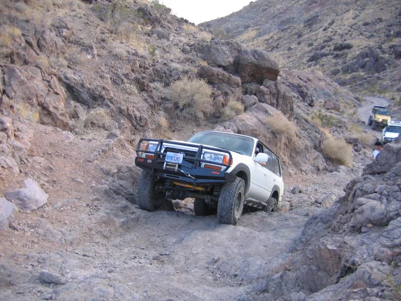

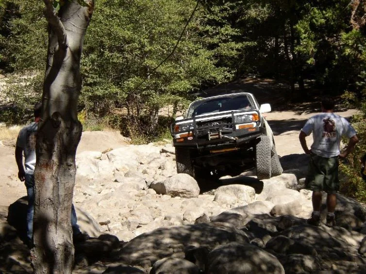

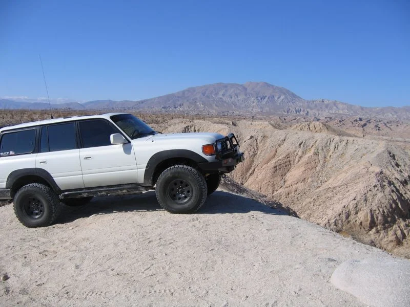

1. Unfortunately I lost the disk with all of my early pics of the truck so this is the best before I have. Besides you all know what a stock white 80 looks like.

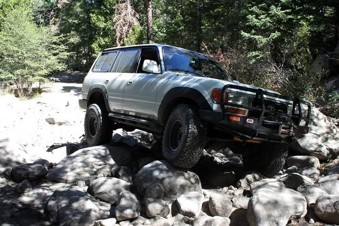

2. Heavies and 25mm packers with 315’s

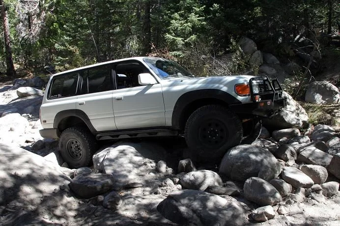

3. Current set up with 3.5” FOR springs no spacers and 315’s, link to write up Here

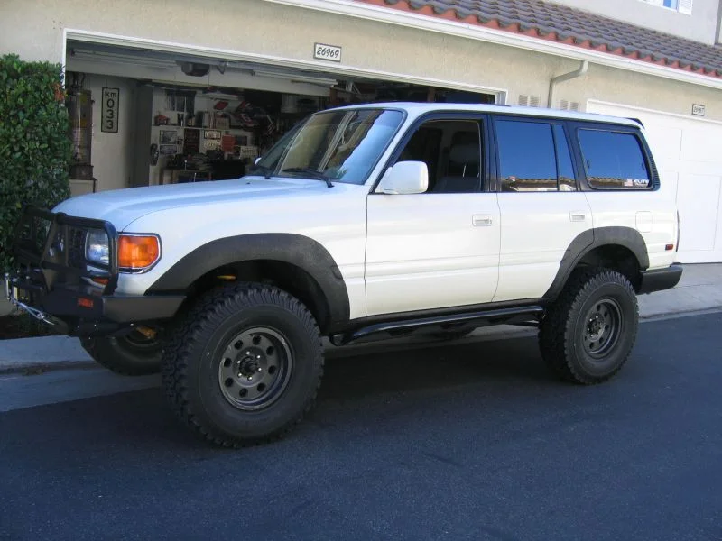

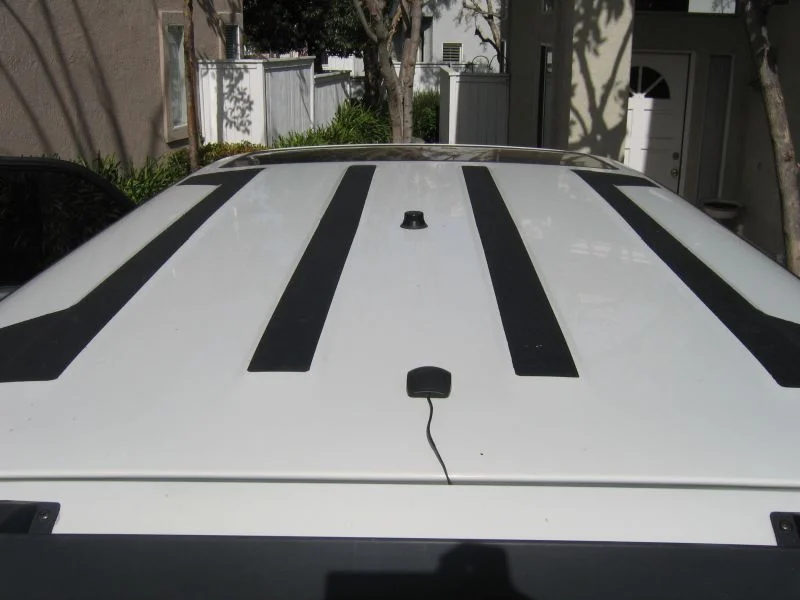

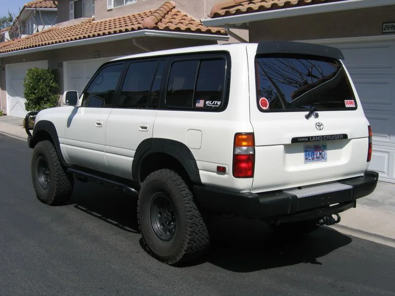

1. Back, rear bumper corners and receiver are off now and rear bumper is being fabbed
2. Roof Durabked with XM antenna at rear and CB/2 Meter antenna base forward.

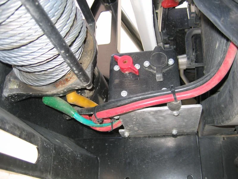

3. Bottom up view of the plate I made to mount MileMarker 9500 winch in ARB. Mounts to top of USPS frame rail with two of the bolts used to install the ARB. No spacers on winch.

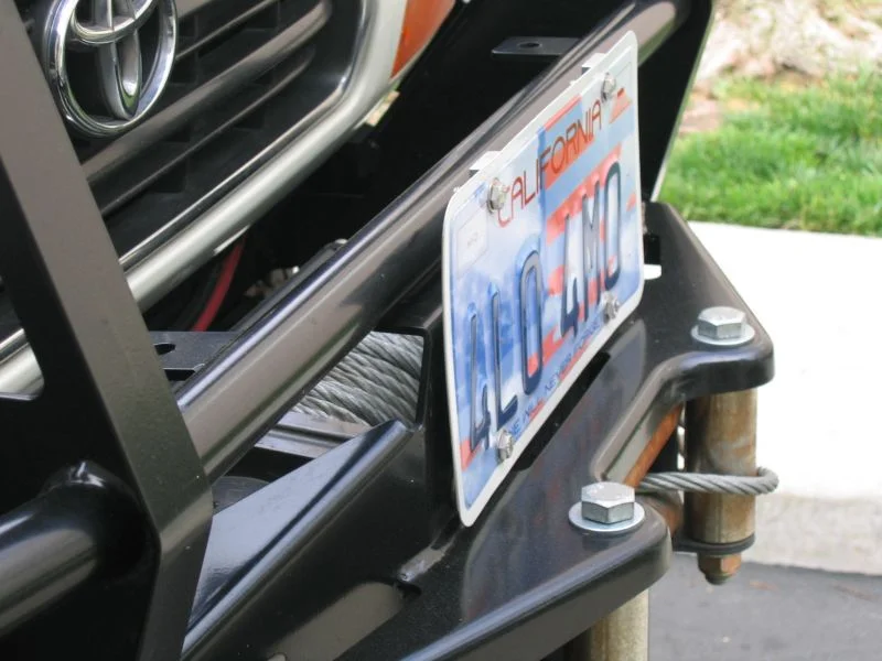

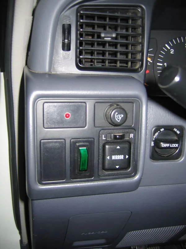

1. Front license plate mounted as tight and low as possible, also so it won’t bend from air pressure as with the ARB mount that only holds it on the bottom two holes.
2. First actual Mod, Tillie dog my official co-pilot

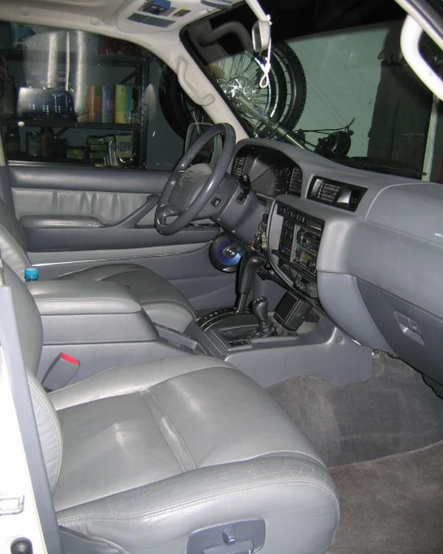

3. Front interior, I tried to keep it as clean and uncluttered as possible

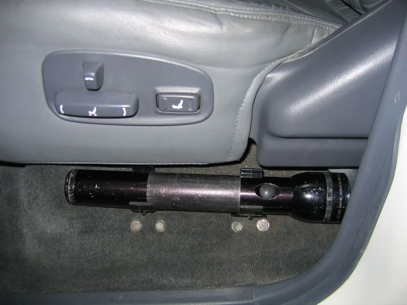

1. Mag light mounted under/along driver’s seat

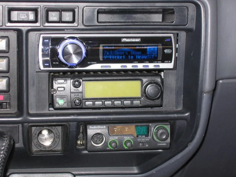

3. Radio set up in center dash, OEM CDL is just out of frame, link to write up Here

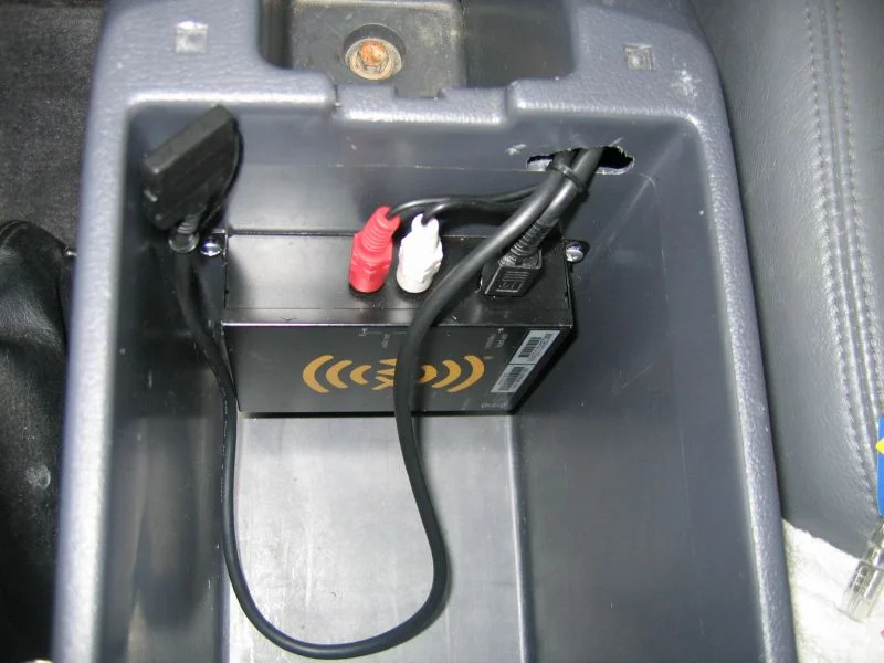

1. Main XM reciever and Ipod connection for head unit, XM adapter inside shifter console. , toggle to switch between CB or 2 Meter to external speaker is barely visible by the ebrake handle boot in upper left of the pic

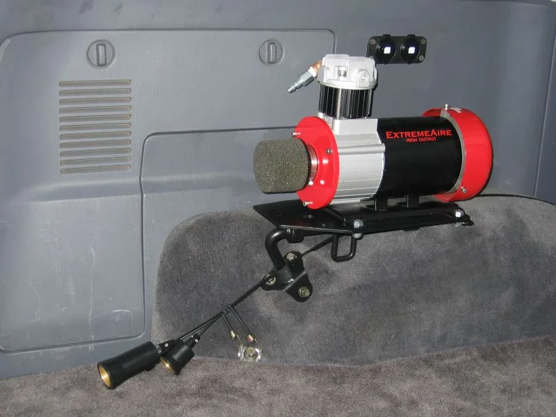

2. Cargo area with compressor mount, dual aux power outlets, and permanent antenna/coil storage.

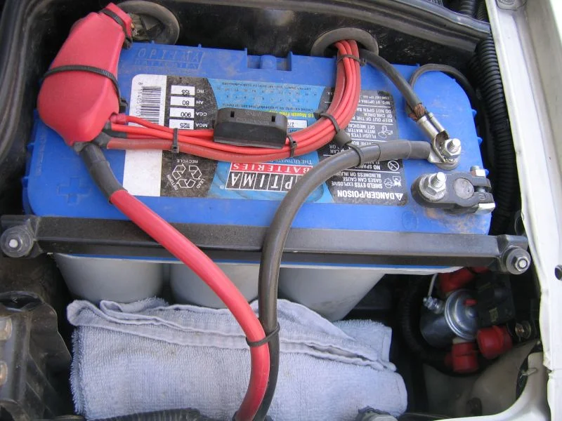

3. Group 31 blue top and 100 amp relay and circuit breaker for compressor. Quart of Mobil 1 wrapped in towel.

More wheeling shots
1. Posing while goofing off before 315’s, still trying to completely kill the 275’s

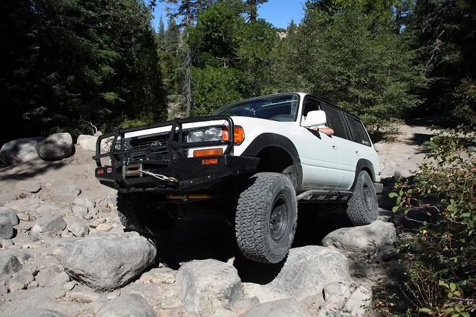

2. Holcomb Creek trail in Big Bear

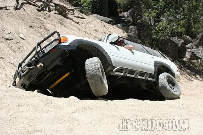

3. Anza Borrego very close to El Diablo Drop Off
