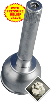

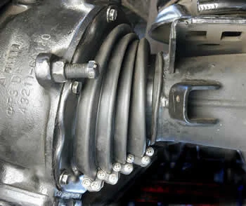

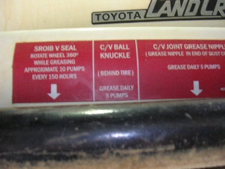

Make sure you measure your birf's length before ordering since there are two diferent lengths. Not a total problem because everything else fits. The solutions are proper drive flange thickness or spacers and extended dust caps if you end up with the wrong unit.
BTW I was just handed a set of birfs with grease fittings at the dust cap ends which offer the ability to get grease into the cage without removal, plus PRV/water release valves which will replace the normal filler plug for my 93. These birfs have been used in our Canadian underground mines for close to twenty years. I have spoken to our supplier and he is willing to help with any requirements.

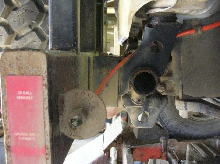

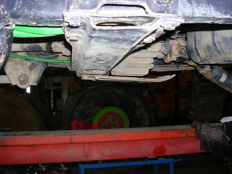

Birfs, Grease and misc.
A few more photos

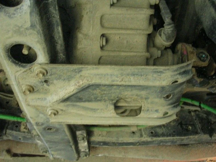

Skid plate

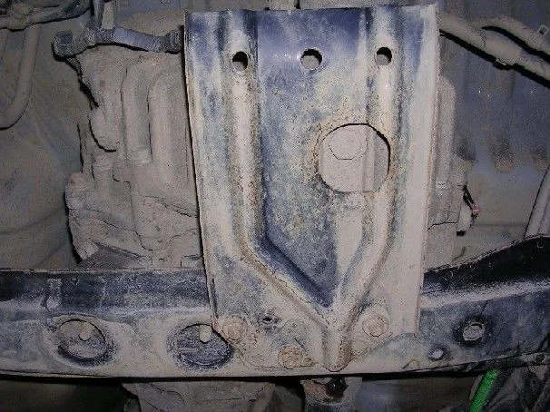

Skid Plate with drain

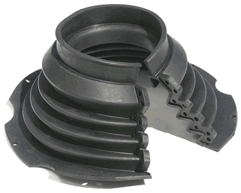

CV Boots
Some of you may like this sort of thing... Copied from Supplier
Prevent the attack of corrosive water,
grit abrasion, pitting, and seal damage
on the exposed Landcruiser axle
and swivel housing and king
pin bearings.
No more hard chroming of the
housing to extend working life.
No more seal destruction, grease
dilution and housing wear.
Contaminants that grind away
at the housing and seals
causing a full front end
replacement are kept
well at bay.
The fully sealed rubber boot
makes the housing impervious
to the wear and tear that is
a common problem on tough
off road conditions
