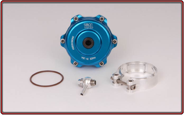

Blow-Off (Bypass) Valves
The Blow-Off valve (BOV) is a pressure relief device on the intake tract to prevent the turbo’s compressor from going into surge. The BOV should be installed between the compressor discharge and the throttle body, preferably downstream of the charge air cooler (if equipped). When the throttle is closed rapidly, the airflow is quickly reduced, causing flow instability and pressure fluctuations. These rapidly cycling pressure fluctuations are the audible evidence of surge. Surge can eventually lead to thrust bearing failure due to the high loads associated with it.
Blow-Off valves use a combination of manifold pressure signal and spring force to detect when the throttle is closed. When the throttle is closed rapidly, the BOV vents boost in the intake tract to atmosphere to relieve the pressure; helping to eliminate the phenomenon of surge.

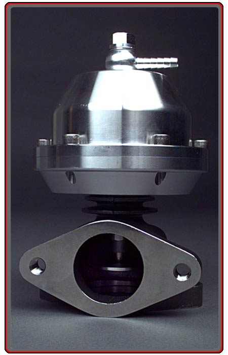

Wastegates

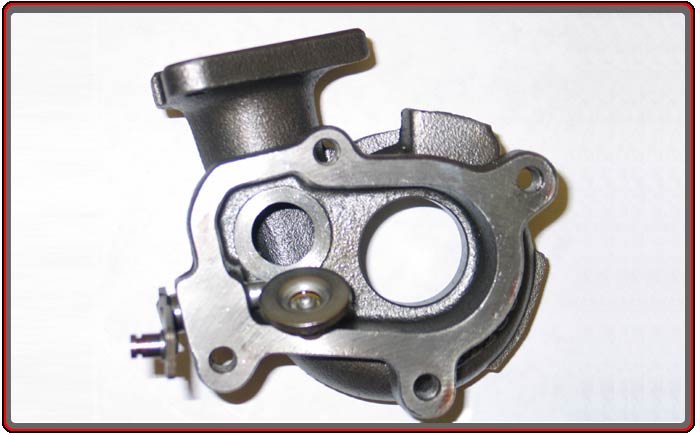

On the exhaust side, a Wastegates provides us a means to control the boost pressure of the engine. Some commercial diesel applications do not use a Wastegates at all. This type of system is called a free-floating turbocharger.
However, the vast majority of gasoline performance applications require a Wastegates. There are two (2) configurations of Wastegates, internal or external. Both internal and external Wastegates provide a means to bypass exhaust flow from the turbine wheel. Bypassing this energy (e.g. exhaust flow) reduces the power driving the turbine wheel to match the power required for a given boost level. Similar to the BOV, the Wastegates uses boost pressure and spring force to regulate the flow bypassing the turbine.
Internal Wastegates are built into the turbine housing and consist of a “flapper” valve, crank arm, rod end, and pneumatic actuator. It is important to connect this actuator only to boost pressure; i.e. it is not designed to handle vacuum and as such should not be referenced to an intake manifold.
External Wastegates are added to the exhaust plumbing on the exhaust manifold or header. The advantage of external Wastegates is that the bypassed flow can be reintroduced into the exhaust stream further downstream of the turbine. This tends to
improve the turbine’s performance. On racing applications, this Wastegated exhaust flow can be vented directly to atmosphere.

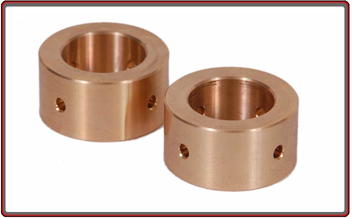

Journal Bearings vs. Ball Bearings
The journal bearing has long been the brawn of the turbocharger, however a ball-bearing cartridge is now an affordable technology advancement that provides significant performance improvements to the turbocharger.
Ball bearing innovation began as a result of work with the Garrett Motorsports group for several racing series where it received the term the ‘cartridge ball bearing’. The cartridge is a single sleeve system that contains a set of angular contact ball bearings on either end, whereas the traditional bearing system contains a set of journal bearings and a thrust bearing

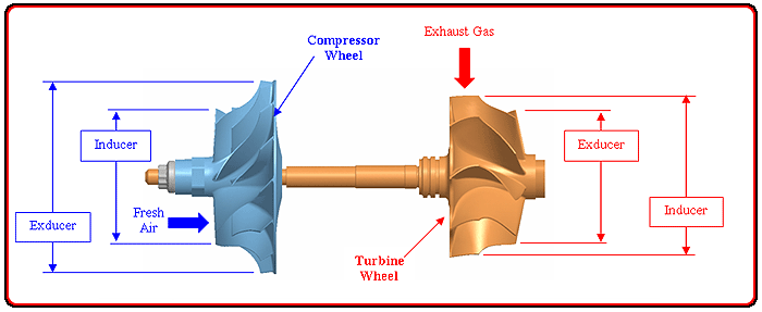

Trim is a common term used when talking about or describing turbochargers. For example, you may hear someone say "I have a GT2871R ' 56 Trim ' turbocharger. What is 'Trim?' Trim is a term to express the relationship between the inducer* and exducer* of both turbine and compressor wheels. More accurately, it is an area ratio.
* The inducer diameter is defined as the diameter where the air enters the wheel, whereas the exducer diameter is defined as the diameter where the air exits the wheel.
Based on aerodynamics and air entry paths, the inducer for a compressor wheel is the smaller diameter. For turbine wheels, the inducer it is the larger diameter (see Figure 1.)
Figure 1. Illustration of the inducer and exducer diameter of compressor and turbine wheels
Example #1: GT2871R turbocharger (Garrett part number 743347-2) has a compressor wheel with the below dimensions. What is the trim of the compressor wheel?

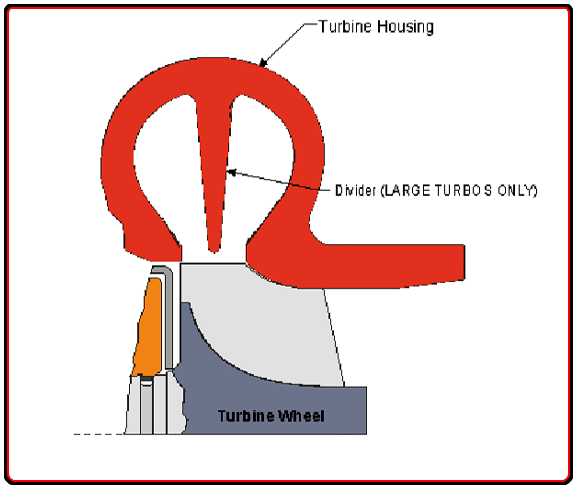

2. Understanding housing sizing: A/R
A/R (Area/Radius) describes a geometric characteristic of all compressor and turbine housings. Technically, it is defined as:
the inlet (or, for compressor housings, the discharge) cross-sectional area divided by the radius from the turbo centerline to the centroid of that area (see Figure 2.).
Figure 2. Illustration of compressor housing showing A/R characteristic
The A/R parameter has different effects on the compressor and turbine performance, as outlined below.
Compressor A/R - Compressor performance is comparatively insensitive to changes in A/R. Larger A/R housings are sometimes used to optimize performance of low boost applications, and smaller A/R are used for high boost applications. However, as this influence of A/R on compressor performance is minor, there are not A/R options available for compressor housings.
Turbine A/R - Turbine performance is greatly affected by changing the A/R of the housing, as it is used to adjust the flow capacity of the turbine. Using a smaller A/R will increase the exhaust gas velocity into the turbine wheel. This provides increased turbine power at lower engine speeds, resulting in a quicker boost rise. However, a small A/R also causes the flow to enter the wheel more tangentially, which reduces the ultimate flow capacity of the turbine wheel. This will tend to increase exhaust backpressure and hence reduce the engine's ability to "breathe" effectively at high RPM, adversely affecting peak engine power.
Conversely, using a larger A/R will lower exhaust gas velocity, and delay boost rise. The flow in a larger A/R housing enters the wheel in a more radial fashion, increasing the wheel's effective flow capacity, resulting in lower backpressure and better power at higher engine speeds.
When deciding between A/R options, be realistic with the intended vehicle use and use the A/R to bias the performance toward the desired powerband characteristic.
Here's a simplistic look at comparing turbine housing geometry with different applications. By comparing different turbine housing A/R, it is often possible to determine the intended use of the system.
Imagine two 3.5L engines both using GT30R turbochargers. The only difference between the two engines is a different turbine housing A/R; otherwise the two engines are identical:
1. Engine #1 has turbine housing with an A/R of 0.63
2. Engine #2 has a turbine housing with an A/R of 1.06.
What can we infer about the intended use and the turbocharger matching for each engine?
Engine#1: This engine is using a smaller A/R turbine housing (0.63) thus biased more towards low-end torque and optimal boost response. Many would describe this as being more "fun" to drive on the street, as normal daily driving habits tend to favor transient response. However, at higher engine speeds, this smaller A/R housing will result in high backpressure, which can result in a loss of top end power. This type of engine performance is desirable for street applications where the low speed boost response and transient conditions are more important than top end power.
Engine #2: This engine is using a larger A/R turbine housing (1.06) and is biased towards peak horsepower, while sacrificing transient response and torque at very low engine speeds. The larger A/R turbine housing will continue to minimize backpressure at high rpm, to the benefit of engine peak power. On the other hand, this will also raise the engine speed at which the turbo can provide boost, increasing time to boost. The performance of Engine #2 is more desirable for racing applications than Engine #1 where the engine will be operating at high engine speeds most of the time.

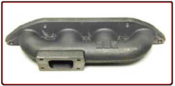

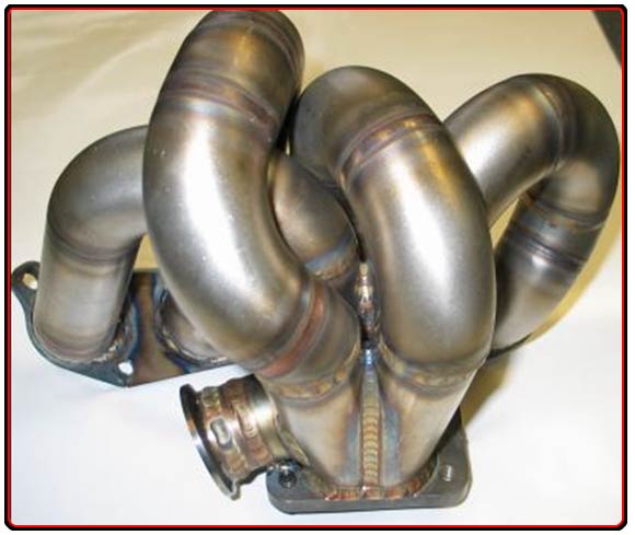

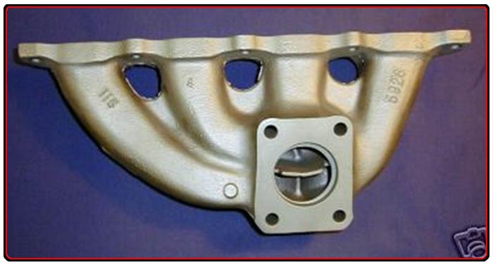

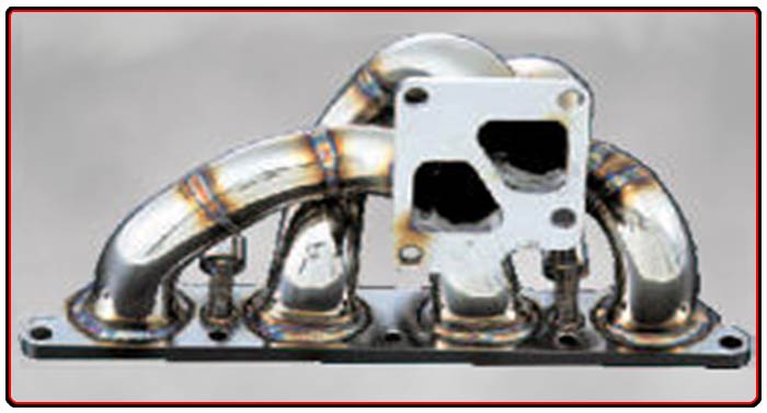

3. Different types of manifolds (advantages/disadvantages log style vs. equal length)
There are two different types of turbocharger manifolds; cast log style (see Figure 3.) and welded tubular style (see Figure 4.).
Figure 3. Cast log style turbocharger manifold
Figure 4. Welded tubular turbocharger manifold
Manifold design on turbocharged applications is deceptively complex as there many factors to take into account and trade off
General design tips for best overall performance are to:
Maximize the radius of the bends that make up the exhaust primaries to maintain pulse energy
Make the exhaust primaries equal length to balance exhaust reversion across all cylinders
Avoid rapid area changes to maintain pulse energy to the turbine
At the collector, introduce flow from all runners at a narrow angle to minimize "turning" of the flow in the collector
For better boost response, minimize the exhaust volume between the exhaust ports and the turbine inlet
For best power, tuned primary lengths can be used
Cast manifolds are commonly found on OEM applications, whereas welded tubular manifolds are found almost exclusively on aftermarket and race applications. Both manifold types have their advantages and disadvantages. Cast manifolds are generally very durable and are usually dedicated to one application. They require special tooling for the casting and machining of specific features on the manifold. This tooling can be expensive.
On the other hand, welded tubular manifolds can be custom-made for a specific application without special tooling requirements. The manufacturer typically cuts pre-bent steel U-bends into the desired geometry and then welds all of the components together. Welded tubular manifolds are a very effective solution. One item of note is durability of this design. Because of the welded joints, thinner wall sections, and reduced stiffness, these types of manifolds are often susceptible to cracking due to thermal expansion/contraction and vibration. Properly constructed tubular manifolds can last a long time, however. In addition, tubular manifolds can offer a substantial performance advantage over a log-type manifold.
A design feature that can be common to both manifold types is a " DIVIDED MANIFOLD" , typically employed with " DIVIDED " or "twin-scroll" turbine housings. Divided exhaust manifolds can be incorporated into either a cast or welded tubular manifolds (see Figure 5. and Figure 6.).
Figure 5. Cast manifold with a divided turbine inlet design feature
Figure 6. Welded tubular manifold with a divided turbine inlet design feature
The concept is to DIVIDE or separate the cylinders whose cycles interfere with one another to best utilize the engine's exhaust pulse energy.
For example, on a four-cylinder engine with firing order 1-3-4-2, cylinder #1 is ending its expansion stroke and opening its exhaust valve while cylinder #2 still has its exhaust valve open (cylinder #2 is in its overlap period). In an undivided exhaust manifold, this pressure pulse from cylinder #1's exhaust blowdown event is much more likely to contaminate cylinder #2 with high pressure exhaust gas. Not only does this hurt cylinder #2's ability to breathe properly, but this pulse energy would have been better utilized in the turbine.
The proper grouping for this engine is to keep complementary cylinders grouped together-- #1 and #4 are complementary; as are cylinders #2 and #3.
Figure 7. Illustration of divided turbine housing
Because of the better utilization of the exhaust pulse energy, the turbine's performance is improved and boost increases more quickly.

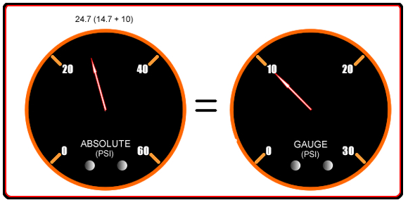

It is important to use units of Absolute Pressure for both P1c and P2c. Remember that Absolute Pressure at sea level is 14.7 psia (in units of psia, the a refers to “absolute”). This is referred to as standard atmospheric pressure at standard conditions.
Gauge Pressure (in units of psig, the g refers to “gauge”) measures the pressure above atmospheric, so a gauge pressure reading at atmospheric conditions will read zero. Boost gauges measure the manifold pressure relative to atmospheric pressure, and thus are measuring Gauge Pressure. This is important when determining P2c. For example, a reading of 12 psig on a boost gauge means that the air pressure in the manifold is 12 psi above atmospheric pressure. For a day at standard atmospheric conditions,
12 psig + 14.7 psia = 26.7 psi absolute pressure in the manifold
The pressure ratio at this condition can now be calculated:
26.7 psia / 14.7 psia = 1.82

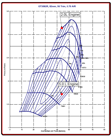

We now have enough information to plot these operating points on the compressor map. First we will try a GT2860RS. This turbo has a 60mm, 60 trim compressor wheel.
Clearly this compressor is too small, as both points are positioned far to the right and beyond the compressor’s choke line.

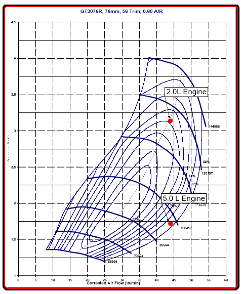

Another potential candidate might be the GT3076R. This turbo has a 76mm, 56 trim compressor wheel:
This is much better; at least both points are on the map! Let’s look at each point in more detail.
For the 2.0L engine this point is in a very efficient area of the map, but since it is in the center of the map, there would be a concern that at a lower engine speeds that it would be near or over the surge line. This might be ok for a high-rpm-biased powerband that might be used on a racing application, but a street application would be better served by a different compressor.
For the 5.0L engine, this looks like a very good street-biased powerband, with the lower engine speeds passing through the highest efficiency zone on the map, and plenty of margin to stay clear of surge. One area of concern would be turbo overspeed when revving the engine past peak power. A larger compressor would place the operating point nearer to the center of the map and would give some additional benefit to a high-rpm-biased powerband. We’ll look at a larger compressor for the 5.0L after we figure out a good street match for the 2.0L engine.

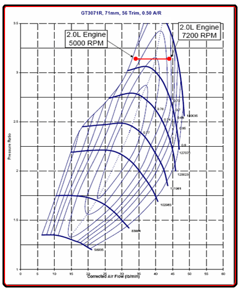

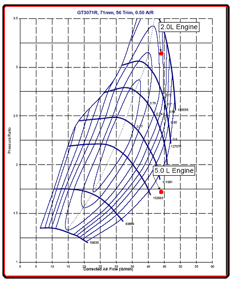

So now lets look at a GT3071R, which uses a 71mm, 56 trim compressor wheel.
For the 2.0L engine, this is a much more mid-range-oriented compressor. The operating point is shifted a bit towards the choke side of the map and this provides additional surge margin. The lower engine speeds will now pass through the higher efficiency zones and give excellent performance and response.
For the 5.0L engine, the compressor is clearly too small and would not be considered.
Now that we have arrived at an acceptable compressor for the 2.0L engine, lets calculate a lower rpm point to put on the map to better get a feel for what the engine operating line will look like. We can calculate this using the following formula:
We’ll choose the engine speed at which we would expect to see peak torque, based on experience or an educated guess. In this case we’ll choose 5000rpm.
Where:
· Wa = Airflowactual (lb/min)
· MAP = Manifold Absolute Pressure (psia) =35.1 psia
· R = Gas Constant = 639.6
· Tm = Intake Manifold Temperature (degrees F) =130
· VE = Volumetric Efficiency = 0.98
· N = Engine speed (RPM) = 5000rpm
· Vd = engine displacement (Cubic Inches, convert from liters to CI by multiplying by 61, ex. 2.0 liters * 61 = 122 CI)
= 34.1 lb/min
Plotting this on the GT3071R compressor map gives the following operating points.
This gives a good representation of the operating line at that boost level, which is well suited to this map. At engine speeds lower than 5000rpm the boost pressure will be lower, and the pressure ratio would be lower, to keep the compressor out of surge.

Boost is measured as the pressure that the turbo creates above atmospheric pressure.
Normal Atmospheric Pressure (1 atm) = 14.7 psi = 760 mm Hg
1 Bar is not actually equal to 14.7 psi, but rather it is equal to 14.5 psi, = 0.9869 atm = 750.062 mm Hg

19. What is the Inducer?
Looking at a compressor wheel, the inducer is the "minor" diameter. For a turbine wheel, the inducer is the "major" diameter. The inducer, in either case, is where flow enters the wheel.
20. What is the Exducer?
Looking at a compressor wheel, the exducer is the "major" diameter. For a turbine wheel, the exducer is the "minor" diameter. The exducer, in either case, is where flow exits the wheel.
Compressor wheel exducer diameter is incorporated into Garrett GT-series nomenclature: The "60" in the GT2860RS for example, has a 60mm compressor wheel exducer diameter.
