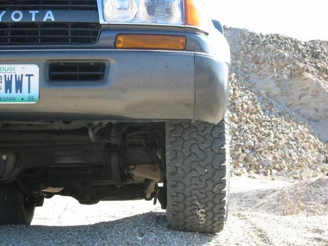

Just wondering what size tires you could fit with ome 2'' med lift ? Thanks
psj1945 is offline   Reply With Quote
Old 12-09-04, 09:41 PM   #41
The quick brown fox .....
Beowulf's Avatar
Join Date: Mar 2003
Location: Somewhere in the foothills...
Posts: 11,989
33's comfortably (285/75R16 or 305/70R16)
-B-

Pic added at the request of another board member....
