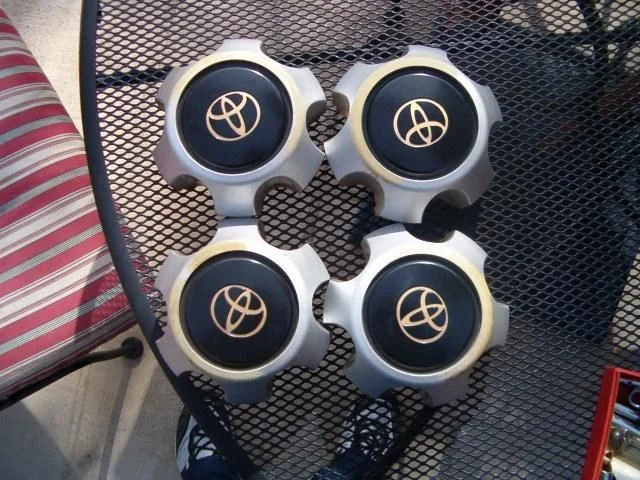

August '09 update - the Duplicolor code 88-00511 Nissan Platinum is still available and is great match.
Just completed restoring my '94 center caps - the were in much worse shape than post #16 above. Taped off the center, used a little 150 grit sandpaper followed up with some steel wool to remove any remaining flakey paint then wiped the caps clean with mineral spirits. Applied 4 coats of paint and 3 coats of clear coat - very light coats each time. Very pleased with the results and match to the rims!
