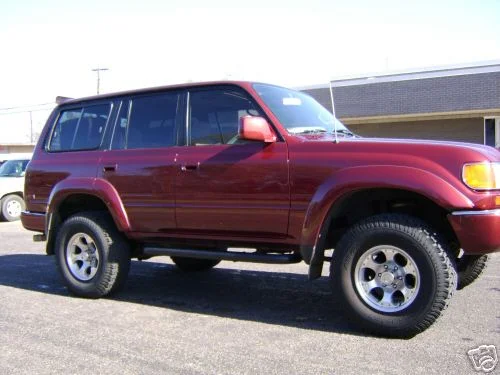

I just bought a 92 FJ80 out of Texas and I really like it. Not much on power, but it will go anywhere. See attached.
