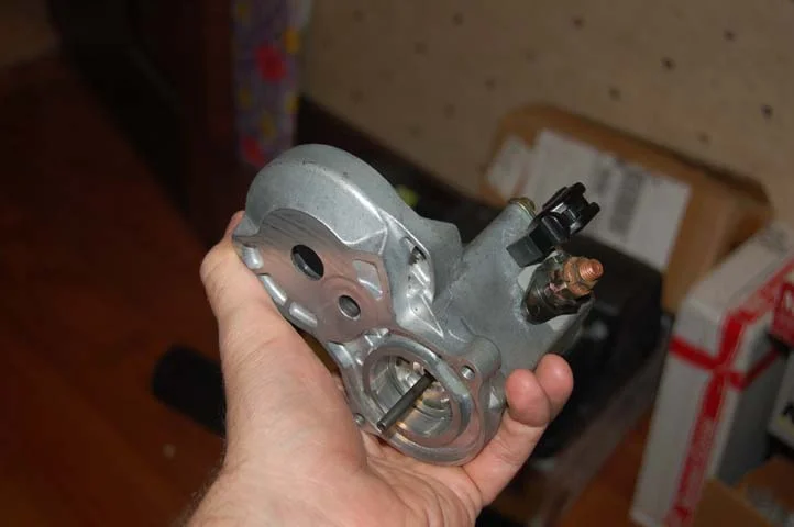

Here is the solenoid I have. It was mounted an ran a few times then removed because it wasn't the problem. Anyone can have it for 75% of CDan's price which would include shipping.
I'll pack it with me on this weeks travels in case someone does want it in a hurry.

I have a used starter I ordered from cruiserparts.net. I'll transfer the solenoid from that over to the one currently being used. Hopefully that'll kill the problem.

That part that I showed is the solenoid, probably a solenoid assembly I guess. I got it from Dan.

I got it from Dan.
Good to know. I thought he only had access to Toyota contacts & plunger or reman starters.
