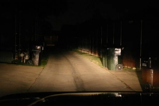

Before with the stock "white" headlight bulbs on low beam
After with the HIR headlight bulbs on low beam
The two pictures were taken with the same D-SLR set to manual over-ride with the same shutter speed, aperature, and ISO settings.
