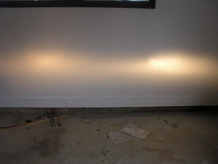

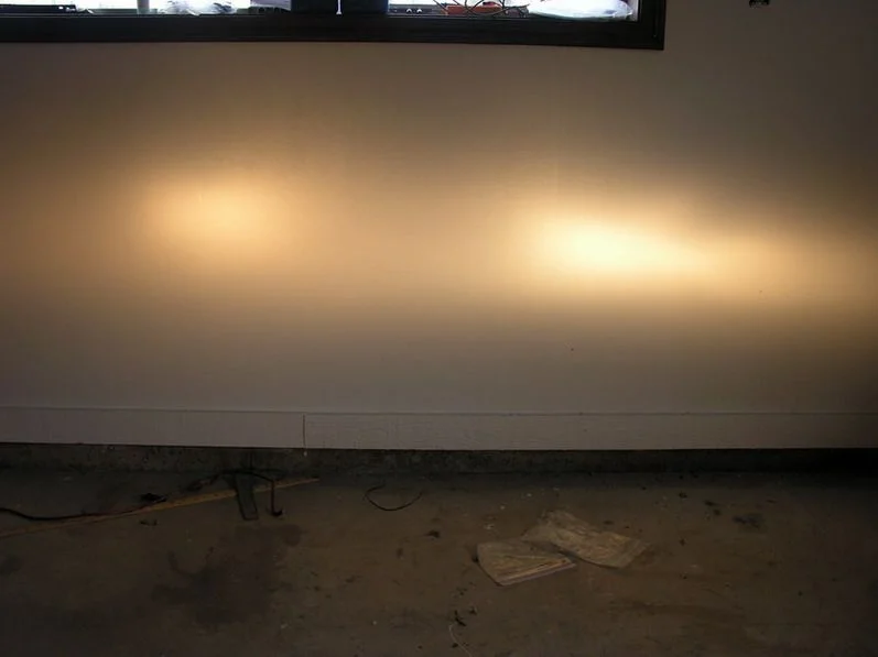

Took 5 minutes to trim the tabs, used diagonal pliers and a flat file. Easy.
The fit is good, not perfect, they could rotate maybe 5 degrees more, but I think good enough.
pass side is stock bulb (51W Kioto) driver side is HIR bulb 55W. This shot was taken in daylight, I'm expecting the difference to be even more visible at night (but not willing to wait to do the 2nd bulb)
I think the light will be much better. I'm happy.
