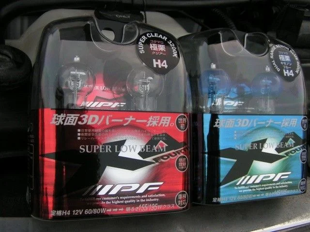

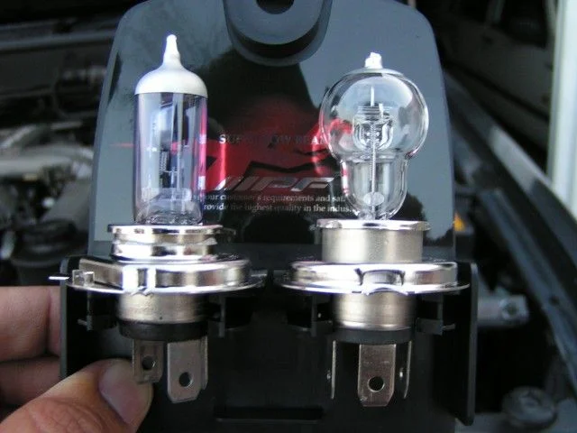

IIRC, the IPF's are not HIR's, or at least that's not what they say on their Japanese web site. Again, going from memory, so I'll try looking it up later...
That said, I've had their blue bulbs in my headlights for a while now and have been fairly happy with them. I've posted pics and stuff, but too lazy to look up the thread.

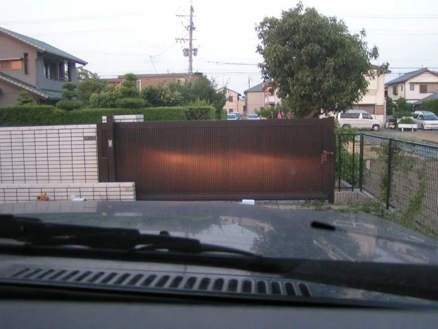

I think the JDM PS/US DS headlight in this picture is the IPF and the other side is the regular, no frills H4, fwiw.
I've used PIAA's for the JDM fog spots and one of them has burned out already (Put them in much later than the IPF's). I'm not knocking PIAA's, and it may not be a fair comparison since they were not used the same way and they were not in the same housings, etc...
Anyway, just my 2 yen...
