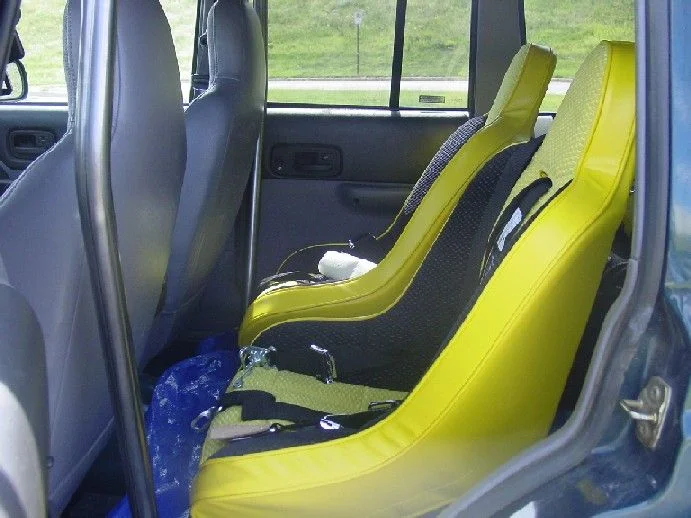

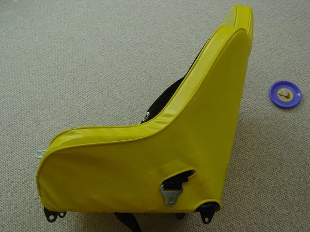

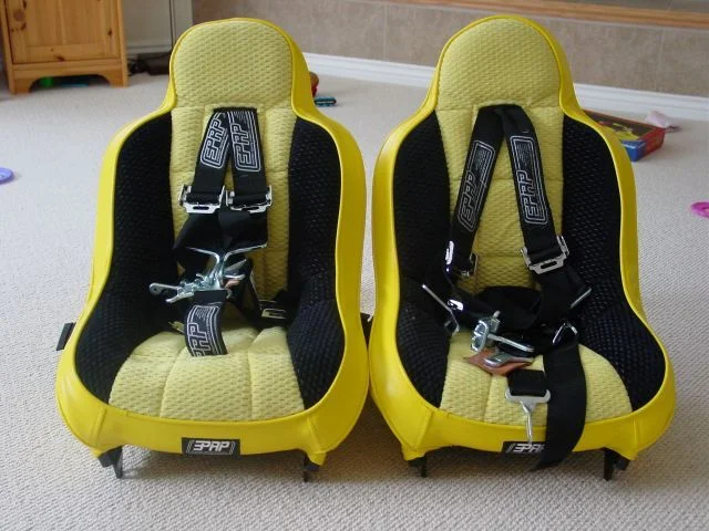

PRP (Premium Racing Products, I believe) makes both preemie (carseat sized) and teen sized five point buckets. I had bought a set of both for an old Jeep project after we were pregnant with our forth, and ended up ditching the project for my 80.
These are built with tabs to bolt into a cage, which means the entire seating system is tied to the cage, rather than part to the cage and part to the body. The seats cost $199/ea last I checked, and the teen size is perfect for booster sized kids.
First two pics are the toddler sized, last pic is the teen sized seats just laying on the floor of my old Jeep, which gives you a size idea. "Teen" really isn't right, it's really the booster seat years up to about age 10-12, depending on the size of the child.

hmm, I wonder how comfortable those would be for the occassional adult passenger?

The teen seats would be too small, unless maybe you are talking about a very petite woman.
Obviously money is an issue on all of these things, but you could build two sets of rails/brackets for the cage mounted seat mounts, and bolt in the teen seat for the kids and an adult sized for when you are wheeling with an adult passenger. You could use the same five point for both, I'd think.
Shouldn't take more than 15-20 minutes to swap out before a trip, and then as your kids get too big for the teen seats you are already set for the adult.
That is exactly how I would do it so my kids can grow with the rig rather than the rig having to grow with the kids.
