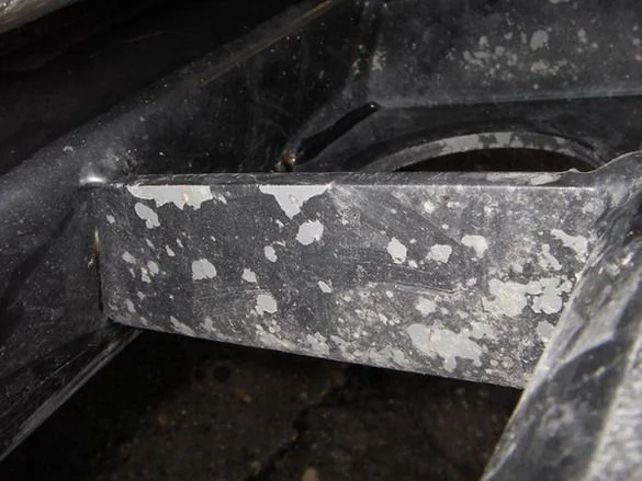

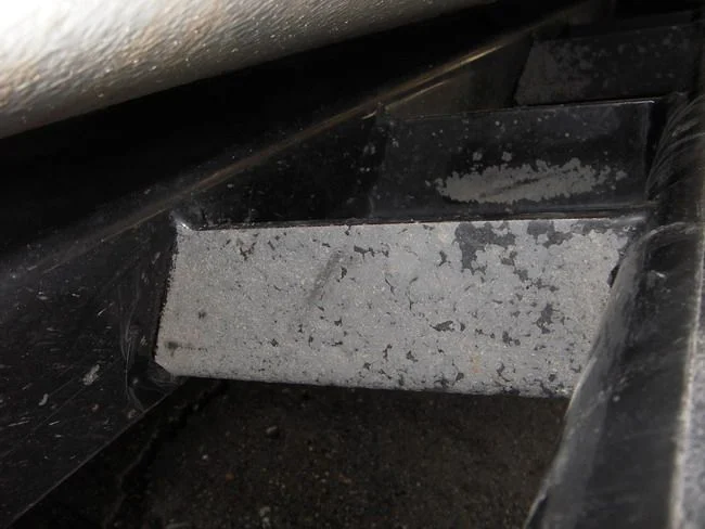

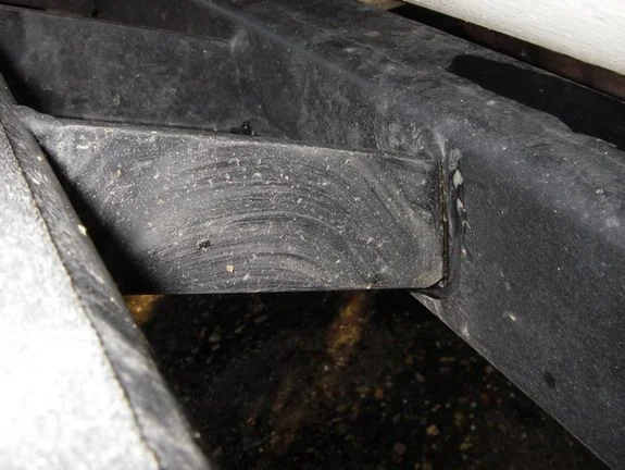

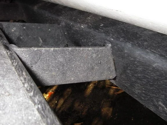

Hey folks,
Just got back from my 3K mile trip through Sonora, MX and Baja.
While getting setup for the trip, I did not put the mudflaps on as I did not know what I would encounter (deep sand, etc) and did not want to tear them off.
Well, I figured I would get a rock ding or two on the rockers and the sliders but take a look at the pics.
The first set shows how much of the powdercoating came off of the fronts of the cross braces. I thought that it was just the tires kicking up road debris but the funny thing is, the one with the most damage is the (edit) second one back, still far away from the front tires line of fire.
Then, I looked at the other side (second set of photos), there is little to no powdercoating missing from that side.
What the?
Could it be a bad coating job?
Any ideas?
Thanks!

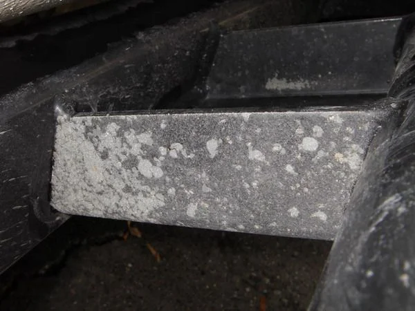

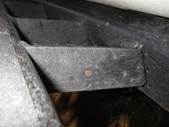

Second Set...
Passenger side.

well, if it's only one side, that would suggest that road grit is not to blame, unless you drove extensively with one side over the berm.....

Looks like it was SPRAY painted with a rattle can...not powdercoating.

Looks like typical desert rock blast to me, one slider probably had a thicker coat than the other. The bottom 1/4 of my rear shocks are paintless just like that.

Some road dirt sand blasting is normal but that much is excessive if they were coated well. Also to have that much of a difference side to side I have to agree with those above that Ken might want to find a new powder coater. I bet there was bad prep and/or very light coating of the powder before baking. It seems to be on one one surface direction which would make sense if the guy putting the powder on didn't shoot enough from a given direction. My Hanna's haven't seen nearly that much dirt road driving but they have a nice thick coating clearly visible on the area's they have been dragged over rocks and no signs of the above flaking. Sounds like you just got the "lucky" set.

Powder coating only attaches itself as well as the prep work on the steel. If the steel was properly wash and a chemical primer (Iron Phos) for an example was incorporated then a chemical etch would have happened and the powder coating would have (bit) into the steel. What I see there is a poor prep job. The coating is not bonded to the surface. Thus the sheeting or pulling away in small patches.
When done properly the coating is one tuff mother....depending on prep, chemistryof the coating and cure cycle. In most cases where welds happen is the first place for failure. Always is even if you use a very aggressive cleaner /phos combination. But properly done I would expect better than you show.
Just my opinon. 22 yrs in the business.

Wheter it was a good prep job or not I can't comment on. However powdercoating will not stand up to sand blasting. Eventually it will come off. I would suggest you look at some of the 3m clear bra type stuff to put on the leading edges to protect them.

The pictures look typical of undercure, causing the powder to become brittle. This is especially the case when primer is used.
Remember, powdercoat has long been sold as a "tougher than wet-paint" finish. While it does have certain advantages over wet paint, it is not indestructable. When powdercoat fails during application due to cosmetics and such, it is then sandblasted off for re-application. The cure process is the most critical in proper adhesion.
Therefore, it might be understandable for powdercoat to chip off when driving where lots of gravel and sand are going to beat up the powdercoat finish.
Listen to Slee, his idea is probably the best for the $$$ once you touch up the bare spots.
