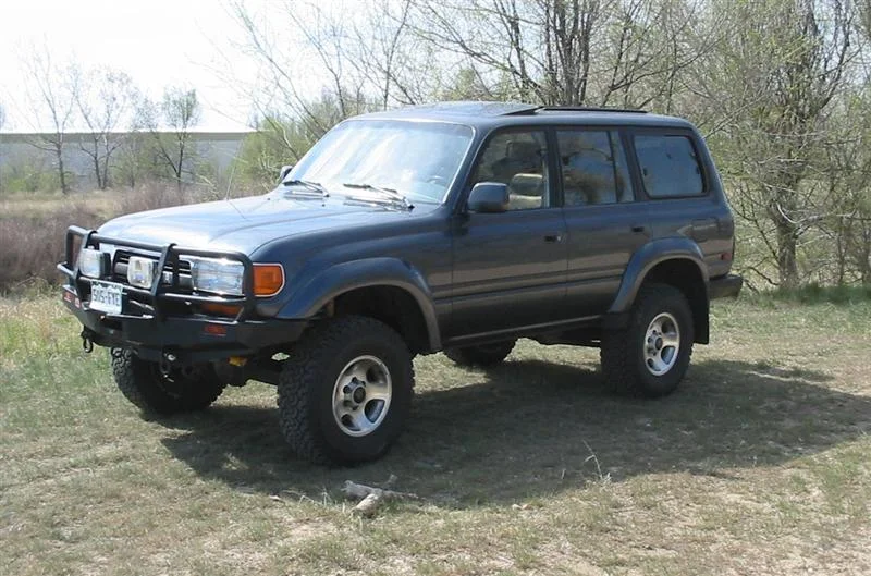

Pic 1: the reason why I'm sportin' the 80...It was an FJCruiser photo shoot in my hometown of Walden, CO... 18 degrees below zero, ice roll...I didn't get hurt but my prized decked out piggy got parted :(
Pic 2: One of the first mods, ARB front bumper...found one used for next to nothing, that next week we went to a family reunion in Kansas and hit a deer at 70mph...no damage to vehicle or bumper...deer not so lucky road pizza, wife finally approved the ARB
Pic 3: The next mod came in the form of a used(and tested!!!) rear TJM bumper from Actionjackson on the board. I had to rebuild the bearing setup and fabricate the rear tire mount section. Basically around the same time the lift went on. Lift is a bastardize/franken-lift that is ever evolving Upon initial install,
Slee 4" front Springs
OME "J" rear springs
OME L shocks
Homemade brakeline extensions, front swaybar spacers, bumpstops
285 BFG A/T's
Slee Front Control Arms

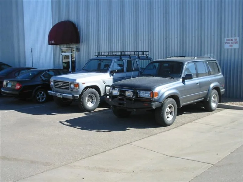

Pic 3: is where I am at now, with 14" rear bilsteins

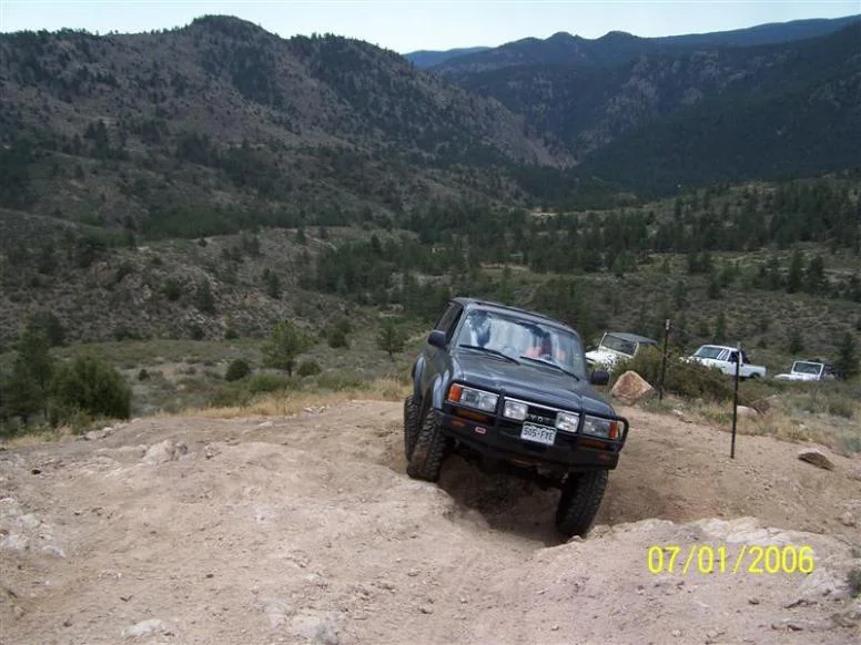

Crystal mountain, I have the "hitch-pin" pulled on this spot. Front end is moving pretty good
This is still OME shocks all the way around, the "L" shocks, very good travel!

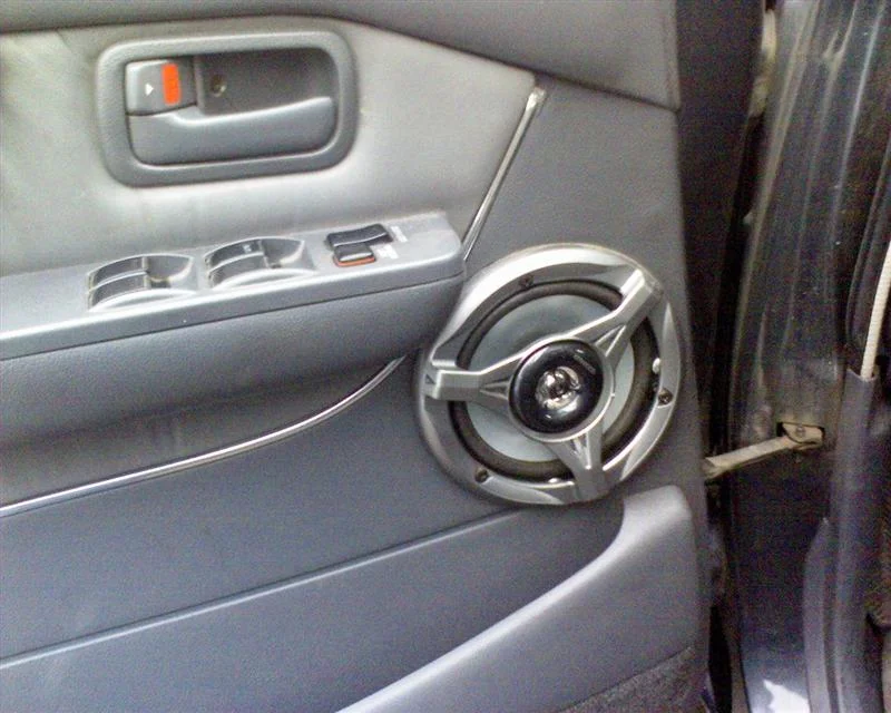

PIC 1: Since my factory speakers were poo...I decided to upgrade! Cheaply, my wife had a gift certificate to a stereo place and we decided to buy these. Sound SO much better than my wife's stock 97 speakers. They are Kenwood 6 1/2" and I had to mount them on the outside of the panel. They sound good and match the interior

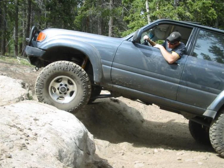

Pic 2: Kelly Flats Wheeling
Pic 3: Crystal Mountain Ledge

Thanks for all the good comments guys. Mine isn't quite a decked out as some but she does alright!
Here is some photo's from last saturday, TJ (pablocruise) and I went up to Kelly Flats to do some wheeling. On the way back I got pulled over in the Poudre Canyon doing 60 in a 35 I actually got a warning I was slowing down off a straighaway going into the narrows which goes from 45 to 35... Thank you Forest Service Officer Huff!!! I honestly did drive the speed limit all the way home.
Pic 1: Climbing part of Hear Attack Hill
Pic 2: Flexing on Posuer Rock, TJ's lil' Sister Katie standing in front, yes she's taller than 5'
Pic 3: you can kinda see the shock mounts and how they work a little better in this pic
FJBen is offline   Reply With Quote
