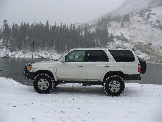

My plans are to keep wheeling in the same stuff for now. I like to go wheeling with my daughters. That's more fun to me then wheeling more challenging stuff.
Both my daughters now have setup rigs
ROD ( Sarah):
daughterofromer (Rachel):
