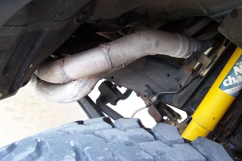

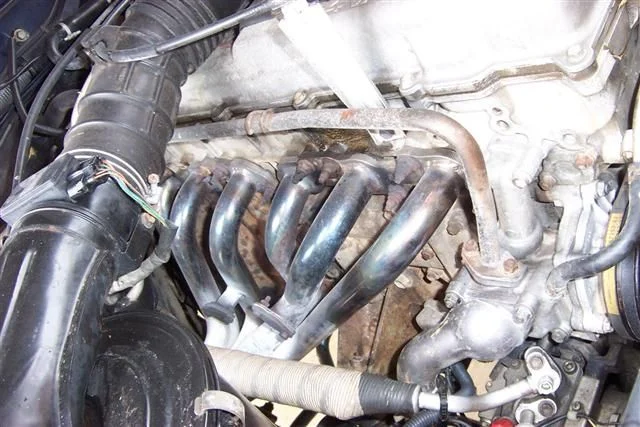

Try swapping out the two stock cats for 1 high flow dynatech. I also went with 3" pipe from the headers back tucking all much higher up under the body and next to the frame. I noticed a significant difference in power. I am starting to wonder about adding one of those superchargers. Was it tough to install?

95 FZJ80 headers, custom collector 2x2.25" into 3" Y-pipe, 3" Flowmaster/mandrel exhaust, LT MAF, 4" OME lift (with CC bushings, x br lines, adj panhards, heavier dropped sways), ARB lockers, 35" Toyo M/Ts, dual dry cell batteries, 2300 watt inverter, speedo corrected, & Kaymar w/carrier

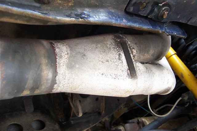

We installed the forward, pre-cat O2 sensor in the flowmaster y-connector. If you look closely in the pic you can see a wire barely looping down from behind the y.
Jegs had an O2 sensor nut to weld in.

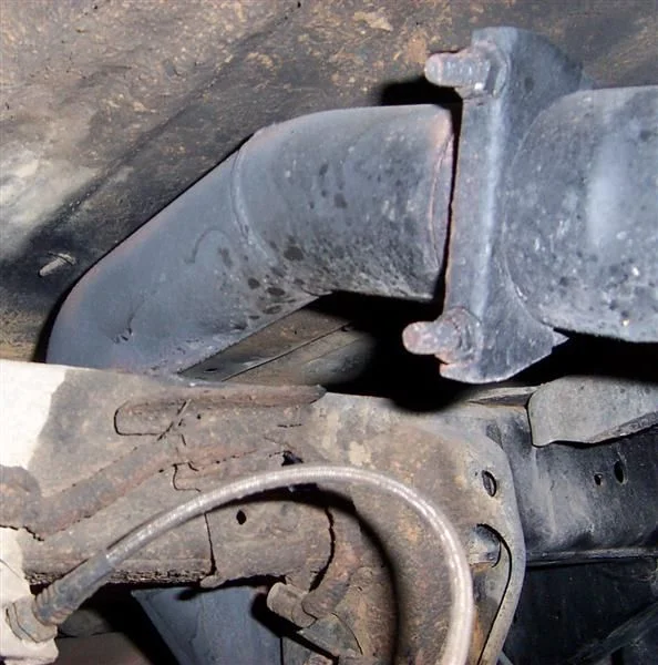

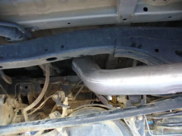

Here are pics of the routing of the pipe over the Frame. It comes out the back behind the tire. I might cut that back and angle it down though (Christo's suggestion)
It's crimpes a bit over the frame, but there is at least 2" of flow vs. the 1" crimp that was there.

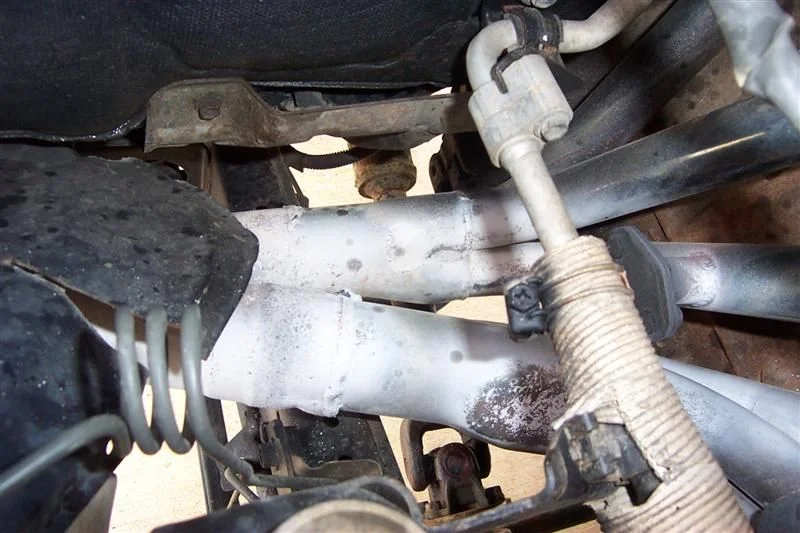

3" pipe w/mandrel bends... http://www.man-a-fre.com/pa2/3inchce...ackexhaust.htm
Information obtained at the time indicated that with the headers, high flow cat, and custom collectors 4.5 liters is the minimum displacement for 3" back without having a negative effect on low end response. Higher RPMs is where I feel some nice pull.
Like my Eastern Ohio/West Virginian clay coating?

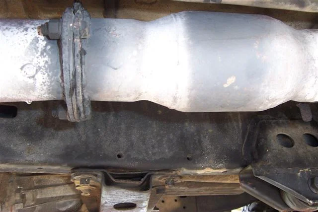

Here is my choke point. Attica, IN was a little rough.
I recently found someone who can help me with fabrications in San Antonio. I need help fixing this and a couple of other things. Good help can be hard to find.
Ken
You better do something about that brake line as its getting too hot and melting like

This is a good link that will provide some discussion and reasoning that could help you with your question.
The key is to keep your exhaust hot as it leaves your pipe with as little restriction as possible. If you 3fe is really cranking 3" may work. Otherwise, it may hurt performance as your exhaust begins to cool too much before it exits.
__________________

I went 2.25" on my 3FE. No cats. It made a huge difference. I went 2.5" on my 94 and I'm not as satisfied with it.

Good post. I may have an idea to make that piece work if I reroute my exhaust between the muffler and the cat. Ihaven't delved in that deeply to know if it would be neccesary.

jamisobe -- so are you in San Antonio, if so we should meet up some time since the LSLC chapter down there is no more.
Anway, with that new cat you put in, did you have any issues with the rear O2 sensor throwing codes?? I want to do somthing similar so I can get the pipe routed over the frame like the '93/'94s.

No code throwin'. We used new sensor nuts from Jegs in locations similar to stock. Everything worked fine. I will say that I had to replace one of my 02 sensors previously.
