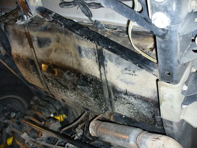

Ken, the problem I see with a side exit exhaust, is no room to put in a rear muffler. IME, you need to have a muffler behind the axle, it's the long pipe you need to take the trumpet resonance out of. Without going custom muffler, about the only one you can use as a shorty hi flow replacement appears to be the 4in round dynomax (12in case length) - WLK 24222, which dictates at least a far rear corner exit.
Don't understand the comment. I have a magnaflow Muffler in the same spot as the stock muffler was.
I cut off the resonator and have the exhaust exiting behind the rear axle, but under the vehicle pointed down and to the side so I don't damage it.
I installed a glass pak muffler prior to the exit to quite it down a bit.
Still a bit throaty, but I think most of that is because it exits under my truck rather than the side or behind.

Here is the picture of the glass pipe below my subtank. just out of the picture, the exhaust angles to the ground and side for the output.
Note this is behind the rear axle
