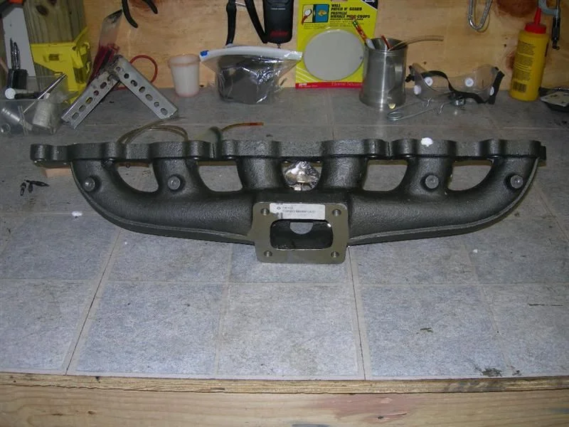

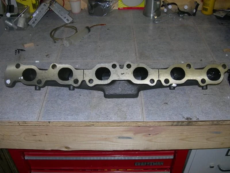

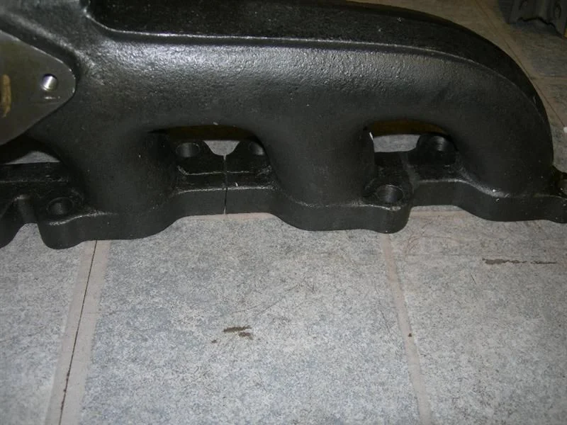

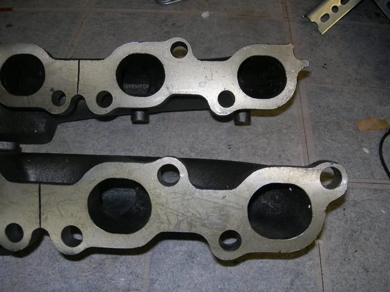

Hi,
I wanted to post a review for the 1FZ-FE turbo manifold that has been foating around on ebay.
I bought the manifold in late Sept. and fedex dropped it off in early Oct. Shipping was around 2 weeks. The first manifold was broken upon arrival(you will see inthe pics). Emailed the ebay seller Autoboost that day. He was great. He replaced the manifold free of charge and shipping after sending a couple of pics. The second one arrived today via fedex. It was in great condition.
The review,
IMO the manifold is a great start point for a buget turbo system. Price is low, and the casting looks pretty good. I think that Dusty's manifold may flow better, but not many people have Dusty's skilling fabing and welding turbo manifolds. The manifold's casting is not what I consider OEM quality but it's not cheap either.
Positives for the manifold,
Machined faces for the exhaust, turbo, outer bolts and external wastegate.
Smooth interior inside the manifold.
Matches very well to the factory metal gaskets
Has holes for heat reflectors on the top of the manifold.
LOW PRICE
Down sides

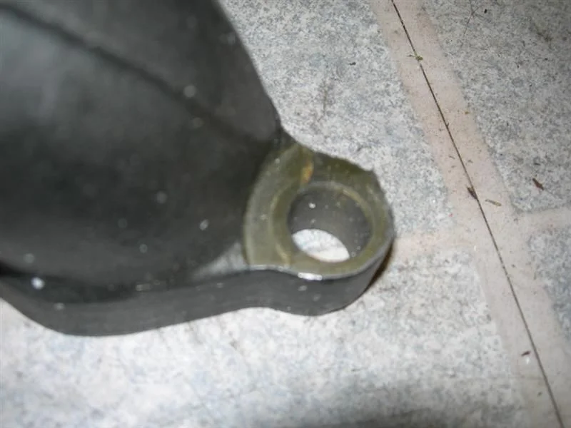

Casting looks pretty thick in some spots. Might crack long term.
Missing the EGR port. (easy to machine in)
Thin casting around the outer bolts.
Weight is pretty high.
I would suggest some type of support to the lower engine/block to the manifold and turbo. Mass is around 26 lbs than add the turbo. Too heavy for my taste hanging off the side of a Aluminum head.
Here are the pics

More pics

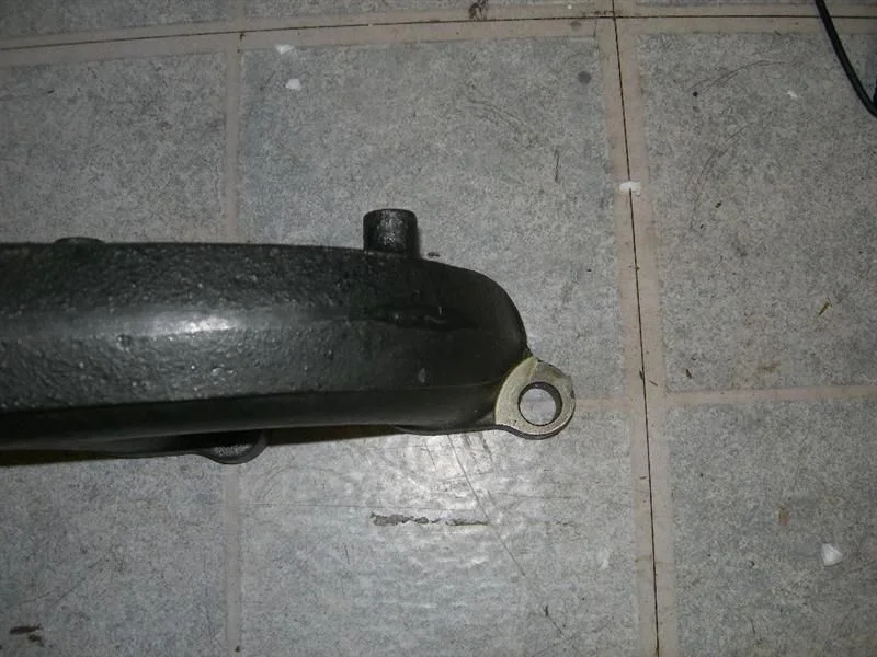

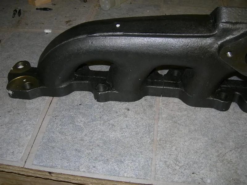

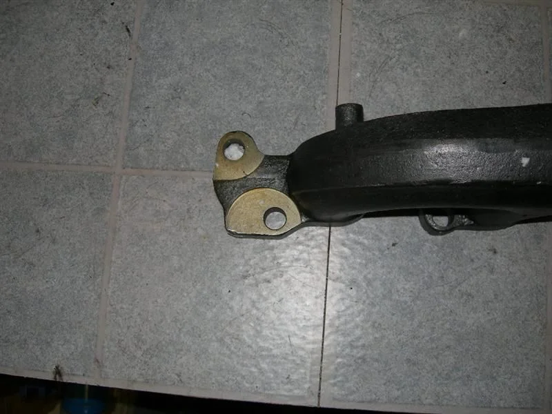

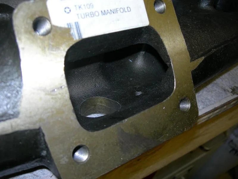

More pics, PM me if you want more.

Thanks for the info, question in the first pic.How come there are crack lines in between those two in the middle? Is it suppose for the heat transferred? but one thing definitely can't beat the price.
Probably to allow some stress relief for movement/elongation when the head heats up.

Yeah, those cuts are there to minimize stress when heated. They allow for the different expansion rates of the header versus the block.

The cuts are for heat expansion of the flange.
