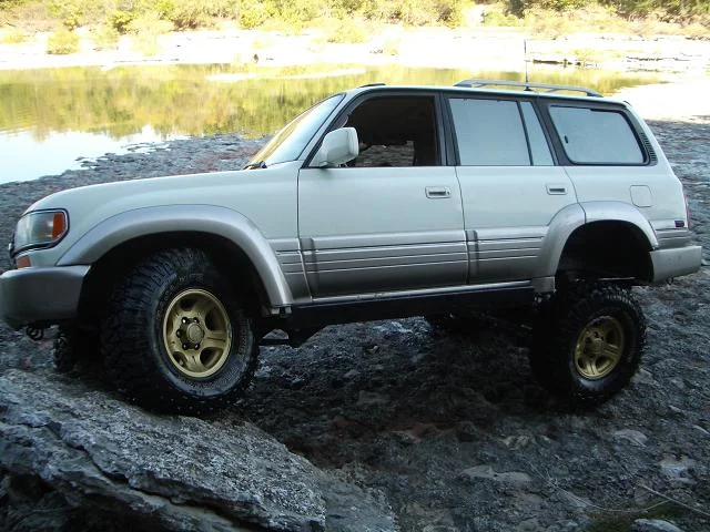

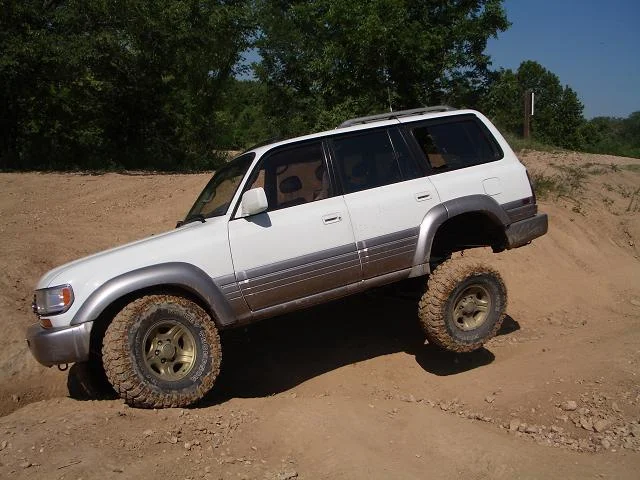

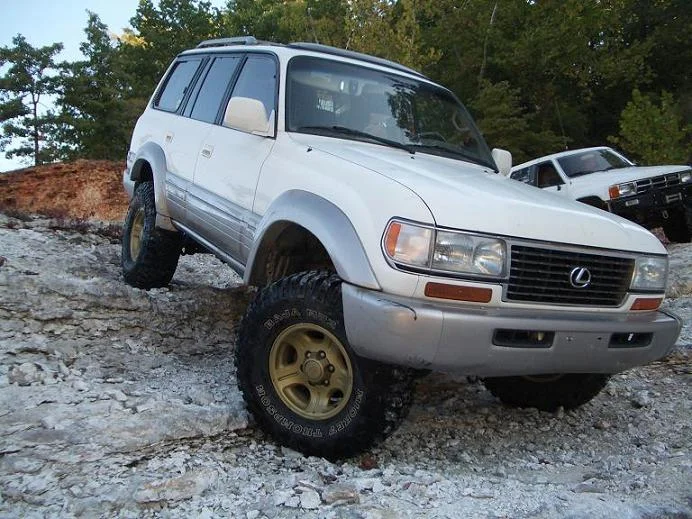

I’ve been into Land Cruisers off and on since 1980 when my dad bought a ’78 FJ55. Spent a lot of time growing up in that truck. Learned to drive in it, spent the night stuck in the middle of Wyoming with it, mom, dad, my bro. and our dog. Etc. etc. good memories. Dad sold it about a year before I got my drivers license. Then summer before my senior year, I bought a ’77 FJ40 50/50 with my dad to fix up. Didn’t quite work out the way we’d planned. I crashed it the first week I had it, but put it back together and drove it my senior year in High School working for a HVAC consulting firm. College came and it had to go. Stayed away from 4x4’s for a while after that. Eventually I ended up buying a ’01 Trooper cause I needed the space and the ability to tow. After visiting my parents in Wyoming and my brother in Idaho, I swung by Moab. A couple of easy trails and I was hooked again. I probably goofed and bought a ’73 V8J40. After putting too much money into the 40 and always having to work to keep it drive-able rather than working on it to make it better, the Trooper started using oil at 75,000 miles. Only solution was to dump it and get an 80 series. Sold the 40 in April to finance birth of my son and new tires. Enough on how I got here, and on to the rig itself.
1997 Lexus LX450 – I’m the second owner, it was purchased at Lexus of Tulsa by some kind of contractor / builder. Still have the original window sticker including the all important locker option.
When I got it, it had 163,000 miles on it, and horrible brakes. I put new Toyota rotors on and 100 series pads first thing. Wish someone had told me I couldn’t use the anti-squeal shims with the 100 series pads, as I fought with them and fought with them, and finally didn’t put them in. 4 months later, read somewhere on here that you couldn’t use the shims.
Now it has 183,000 miles on it, and here’s the set-up.
J-springs – My brother found them used for me
L-shocks – My brother found them used for me
MAF- 3” front drop brackets – Yes, they are lower than running plates, or bushings, but I really like the way it drives with them. I haven’t had any problems getting hung up on them going forward, though I did have an issue for the first time this weekend trying to back up something.
MAF- extended SS brake lines – Bit of advice on replacing the rubber hoses that have been on the vehicle for 9 years and 180,000 miles, make sure you’re ready to change the hard lines too. I could not for the life of me get the hoses free from the rear hard line, and the front right line that is on the axle – the little 5” long one. After replacing that much line I also did a brake fluid flush. Not that I wanted to, but it took that much to get the air out.
MAF – 2” front bump stop drops.

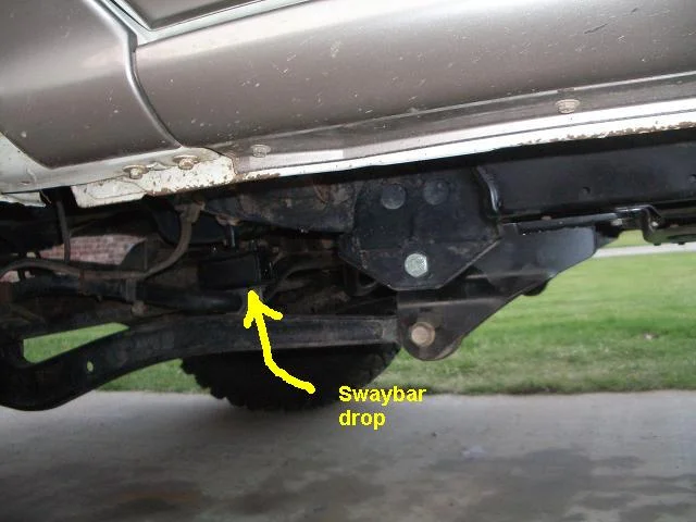

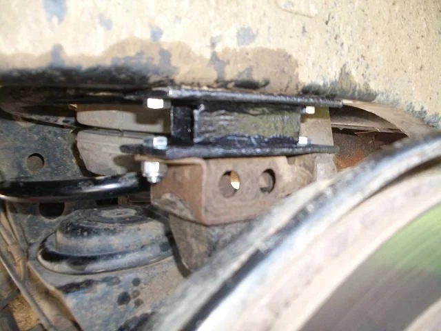

My own rear bump stop drops, 1-1/2” soon to be replaced with a 2” drop. I really wanted to get as much travel out of the shocks as I could, but I’m getting a bit of rubbing on the wheel wells.
My own front sway bar drops – 2”x 2” x ¼” tubing.

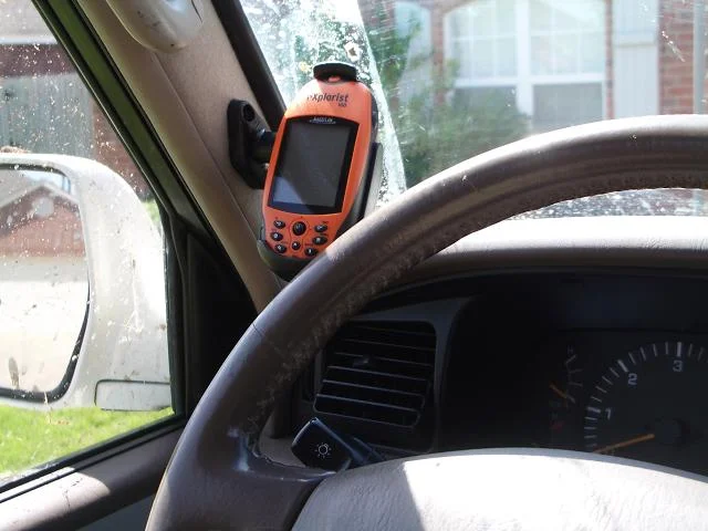

The unusual stuff:

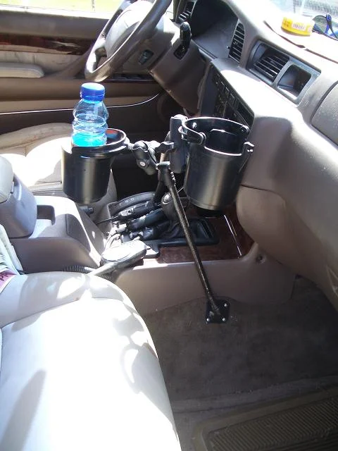

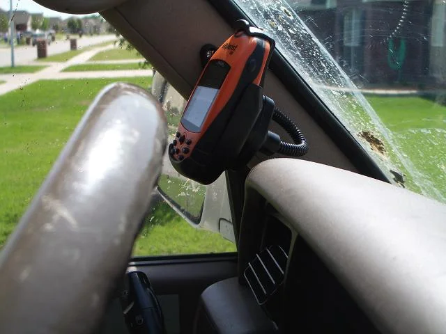

Funky cup holders – They’re RAM Mount drink holders. I did it cause as we all know the stock drink holders are worthless, and I didn’t want to pay a small fortune for a cup holder that covers my radio. The gimbles really do work to keep you from spilling your coke all over.
RAM GPS mount – pretty basic Magellin Explorist, but it does tell me the correct speed I’m going, and it does give an altitude reading.

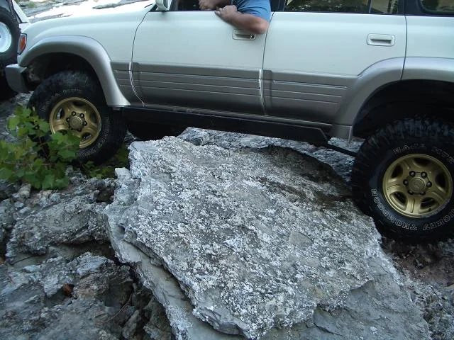

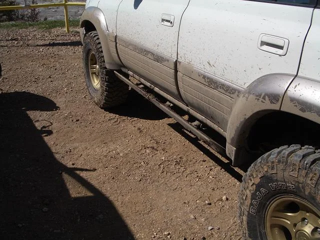

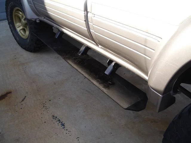

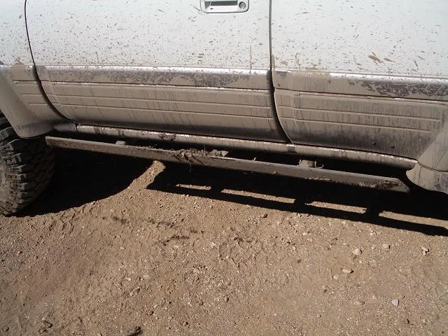

Sliders – now this is my pride and joy so far. My brother gave me a lot of crap about doing this. Said if it took me more than a weekend to build them, I was building them too complicated. I allowed myself to be goaded into doing it, and I’m happy I did. Finally got a chance to use them this weekend, and they worked great. Only problem is I don’t have the passenger side done yet! I’m 80% there, just working out the cat issues. I plan on air actuators to make them go up and down. For now, they’re just pined. One nice side benefit I found this weekend is that with the edge there rather than a tube, they work great for scrapping mud off your feet.

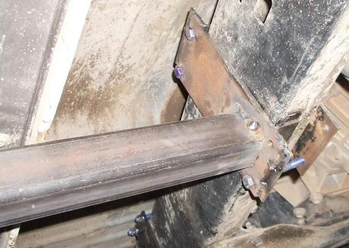

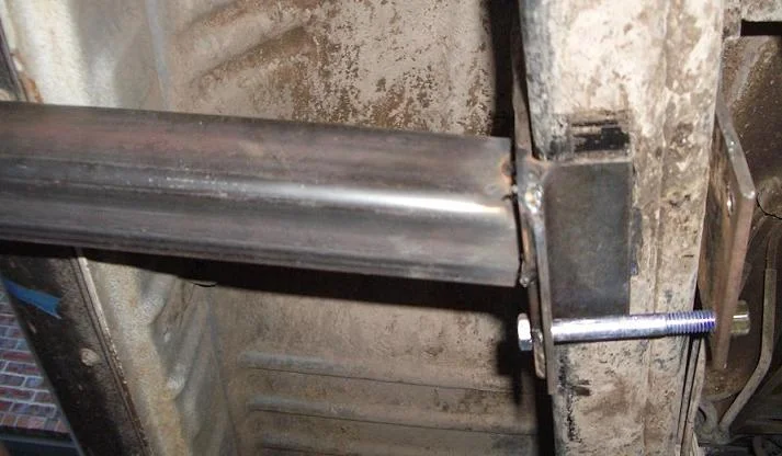

and the mounts are unique, in that I made them to go around the drop brackets and used angle to make them hug the frame tight...
edit - the mounts do have triagulated braces from the mounting plate to the outrigger, just haven't taken any pictures of them since then.

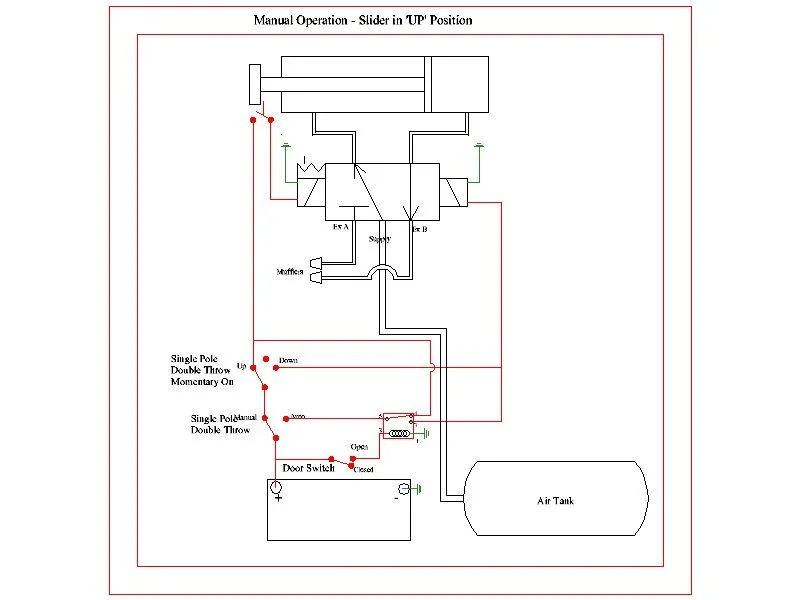

I plan on making them air powered.... which yes, will be more complex than the current pin system, but if you're going to have onboard air anyway.....

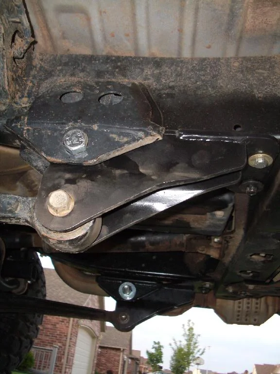

To do the passenger side and take care of the low hanging cats at the same time, I'm replacing the cats with this cat... from Magnaflow. My cats are beat to hell and leaking between them anyway. The rest of the parts came last week, I'm putting in a flex pipe too, just to keep it all from breaking loose flexing.

excellent write up Heath.
thanks for contributing.
those sliders are cool dude.

cute kid. Neat truck. glad the drop brackets work for you. If you fabbed a taper ramp from the drop bracket to the frame perhaps there would be no hangup. Such a ramp would also be a nice place to attach a skid
RAM GPS mount – pretty basic Garmin Etrex, but it does tell me the correct speed I’m going, and it does give an altitude reading.
I totally agree with the rediculous cupholder placement. I can just imagine the look on the faces of the technicians at Eclipse while seeing the dryed up coffee and soda that spilled in my head unit.
BTW... Isn't your GPS unit a Magellan Explorist? I have the Explorist 400 that looks identical to yours but is white in color. I'm not too pleased with the 400 as it is quite cumbersome to interface with a computer and not very user friendly. I am quite impressed with it's accuracy though.
JSF
Yep, it's a Magellan Explorist 100. I didn't really put alot of thought into buying it, I just had a credit at Bass Pro Shop from my Bass Pro Mastercard, so I got the cheapest. Other than speed and corrdinates, it's pretty worthless. Too hard to use for routes and such. If / when I upgrade though, I can still use the same RAM arm and just get a different craddle.
