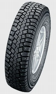

Posts: 96
Has anyone tried Green Diamond Tires or Retreads
Has anyone tried these? I have wanted to try a green diamond mud tire. Get the mud tire for deep snow, slush, mud that an AT will choke on and still have good ice traction.
Green Diamond is a technology developed in Iceland:
"Green Diamond Tires. These tires are specifically intended for winter driving, but are also meant for year-round use. The Green Diamond granules (1 mm), which are comparable in strength to diamonds, are evenly embedded in the tire tread during manufacture. As the tire tread gradually wears, new Green Diamonds continually “appear” on the surface. In addition to being safe, these tires are very environmentally friendly: noise- and air-pollution levels are no greater than from regular, unstudded tires. And Green Diamond tires are particularly well suited for use with ABS break systems."
"Green Diamond tires provide similar traction on ice as studded tires, according to tests conducted by VTI (Swedish Public Roads Administration). And, Green Diamond tires cause 93% less road- wear than studded tires, according to BAST (German Public Roads Administration)."
The following U.S. vendors sell mud tires with Green Diamond as retreads.
http://greendiamondtire.com/ (Sizes up to 31")
http://www.high-tec-retreading.com/diamond.html (Sizes up to 37", image below)
