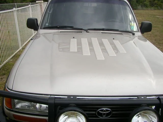

Rick, I did this on an LT1 conversion that lives in Florida. This did make a huge improvement in underhood temps and in this case helped the IAT temp because of the open filament aircleaner. Granted its major work, but it made a 10 degree diff in water temp and a 50 degree diff in IAT. With the GM though, I could go in and change the IAT parameters. GM was looking for a hotter temp relationship between the IAT and the coolant temp just like Toyota.

I don't see where Landtank has made the the connection of the temp of the metal that makes up the air box to the IAT.
I do observe that by opening a hole of 16 square feet above the engine provides better cooling in IAT, Coolant temp in a single test. I am interested in the IAT data vs atmospheric temp while running at 3000 rpm on the highway. And also what the IAT temp is before and after 1 minute leaving a stoplight (say 2 miutes stopped. Running at idle for 30 min is pretty extreme. It is a good test to look for heat soak though.
You might want to consider the dew point will also have a notable effect on the air density.

I'm only intersted in whatever data one can come up with. We agree it's premature and inappropriate to prove anything. I've been advocating only that folks do things and take measures. My experiences here have been that a lot of folks want to be virtual assistants and professors. Taking any type of data isn't rocket science, it only needs to be identified and repeatable. From taking the hood off, to taking the shroud off, to just reading OBD outputs.
I am very interested in taking action and taking measures, I've always done that with my automotive toys. Sharing my mods, my methods and my data with *my* conclusions. What makes that controversial? Only that some folks want to take no action, but tell me what I did wrong. Where's that data?
Rick has taken that to heart here after a lot of prodding. I applaud him for it. I did take a time-out to put forth a gentle reminder that data doesn't prove or disprove anything, it supports or doesn't support other data, clearly identifying possible explanations for either scenario.
What I have notice and consider all-good, is folks have moved from it feels better (that's not *my* origination) to picking up some sort of measuring device and quantifying that. I urge the pundits to encourage this behavior, eventually it might have significance. Right now, mine has none, because the 'n' sample is small, and the specific variables are many.
That shouldn't stop anyone from data collection and reports.

Dew point does indeed affect density. A variable we might be able to address at some point, but normally air density vs altitude use a 'correction factor' for the Dew point. Since Dew point and saturation changes with temperature and altitude, I'm not sure this can be as easily calculated as density vs altitude (proportional) or Density vs temperature (inverse proportional).
What I would expect to see, if 'n' data gets high enough, is that those in hot dry climates (higher density) will see different results of heat management modifications than those in hot moist climes (lower density), or those in cold dry climes (higher density) vs cold moist climes (lower density). These differences might point out significance of changing a specific variable for maximum benefit *given* the ambient operating evironment.
I look at ambient conditions as a variable I can't control. I *can* affect and control engine operating temperatures, I can affect and control lowering pre SC IAT's, I can affect and control underhood engine temps and pressures. I can't control ambient temp, pressure or it's dew point. Hence those are all givens outside the scope of relevence really. It may have some significance as to how much affect and control a given mod has, but that would require a lot more data collection.

It wasn't until I thought I had found a way to take some readings without any additional expense that got me to start to evaluate the system. I wasn't about to buy an IR gun based on what I had read in the ABC threads. Strange thing is that I already had the stuff laying around.
Right now I'm just trying to base line some differences between idling and driving, hood no hood and maybe insulated filter can and not.
With this data I'll first try and evaluate the worth of hood vents and if so, draw some kind of relationship between driving and idling because further testing will be idling only.
If insulating the canister yields some benefits than that will have to be done prior to vent testing.
If I enter that phase, I'll be systematically blocking off the hood opening in an attempt to evaluate where and how big the vents would have to be to have a good impact on engine performance. During this phase is where removing the fan shroud would come in as it would either decrease the need for venting or increase it.
Thought I would just map out what I have in mind for some input.

Tried an experiment with surprising results. The goal was to get cooler air to the air intake at speed, maybe pickup some power for highway hill climbs. Fresh air for the intake is pulled from the cavity between the fender and fender well, supplied from air leaks around the lights and the grill area. I was thinking that opening up the trim under the corner marker light would provide additional cool air at speed.
Put a temp probe in the air filter and went on my delivery, on the way, highway 60 mph 98F ambient, 139F fan output, 112F air filter. Stopped at Costco to feed the truck and I, while waiting on the fuel to pump, popped the right corner light out. Made a nice ~4" x 6" hole with the air intake box very visible, new ram air!
Cruising the parking lot the temp was 12F higher than when I pulled in, WTF? Let it idle in the parking spot and checked the hole, hot air was coming out, not blowing out just a slight movement of warm air. Not better at low speed.
Pigged on some pizza and hit the highway back to the shop, recorded at ~65 mph, 104F ambient, 148F fan output, 143F air filter, played with the speed on surface streets and the worst that I found was at ~30 mph between stop lights 158F fan output, 157F air filter, WTF!
My guess is that the high pressure airflow at the front of the truck, becomes disconnected from the body as it flows around the edge of the fender, making a low pressure area sucking air out of the hole.
The area along the fender well is normally one of the coolest spots under the hood on my truck, to get fan temp air over to the air intake that cool airflow must no longer be there? Anyway not a good place for a vent, if you were willing to make an air scoop it may work, but that is not what I had in mind. It wasn't a total loss, learned something and reinforced the need for careful testing when making airflow changes.
