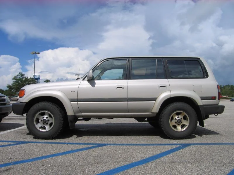

I installed the 861/862 springs and firm OME shocks a few days ago and I really like the ride vs the stock setup after 120k miles. I've already driven three 4 hour trips with lots of interstate, back roads and dirt roads.
I had the LC on an elevated, drive-on lift and took pretty good measurements. It measures 21" on all 4 corners from fender to center of axle.
Btw, I also can't say enough good things about these new 285 BFG AT's. They are as smooth as any highway tire on the interstate. I haven't tried them off-road yet but they have to be better than the stock Michelins in that regard.
FWIW, here's a pic:

Old 08-08-09, 09:46 AM   #16 (permalink)
Forum Lifer
retrofive's Avatar
Join Date: Jan 2008
Location: oregon
Posts: 2,627
Looks good
__________________
'94 LC | JEFFERSON STATE CRUISERS
retrofive is online now   Reply With Quote
Old 08-08-09, 01:07 PM   #17 (permalink)
Forum Regular
KurtKuhn's Avatar
Join Date: Apr 2007
Location: Delawhere?
Posts: 243
WarDamnEagle, I like the results.
Can you post a picture taken from the sunny side?
