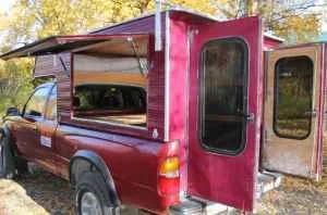

Still looking for a good bed to sleep in? (I think you were the guy looking at making a sleeping set up for a future pickup, if not then oops.) If so then sleep with the bed down and a tarp over your feet. There are some cool campers for these too. I wish I bought this pop up camper for mine last summer. Then had a chance on a sweet topper this winter but was #2 in line and the first guy bought it. pic 2.
Here are some good links with good info on trucks.
pickup Toyota Hilux - Wikipedia, the free encyclopedia
Tacoma Toyota Tacoma - Wikipedia, the free encyclopedia
more pickup info Toyota Pickup and 4Runner Drivetrain Specifications
and Toyota Timeline
I think you will like this, lots of good info here. There are some long bed 7', 89-95 trucks out there but not sure of the packages. I saw a long bed with x-cab and 22re last year up here.
As far as motors go, the 22re all the way. The 3.0 v6 had head gasket problems and is a real pain in the a to work on, not much more power, worse mileage. I could not even get to the oil filter on my cousins 4-runner years back. I get 19mpg in my 22re around town with lift and 33's and 4.88 gears.
Proper gearing is important for smaller motors. I think lots of people think they are a bit more gutless than they are because they are trying to run 31" tires on stock 4.10 gears which does make it less powerful. They came with a stock 28" tire.
If you can afford the newer Tacoma's they are a nicer truck with better engines. The 2.7L 4cyl puts out more power and is basically an updated version of the 22re, and the 3.4 v-6 puts out lots more power. Both the Tacoma engines are great and I have seen lots in the adds with 250K miles.
A tacoma will likley be my next truck upgrade for a daily driver.

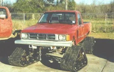

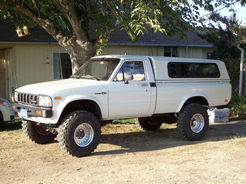

Here is a picture of a gen 1 longbed pu, not to mention the best looking one I hae ever seen.
I could not get the gen 3 pu photo to load.
and one just for fun.
