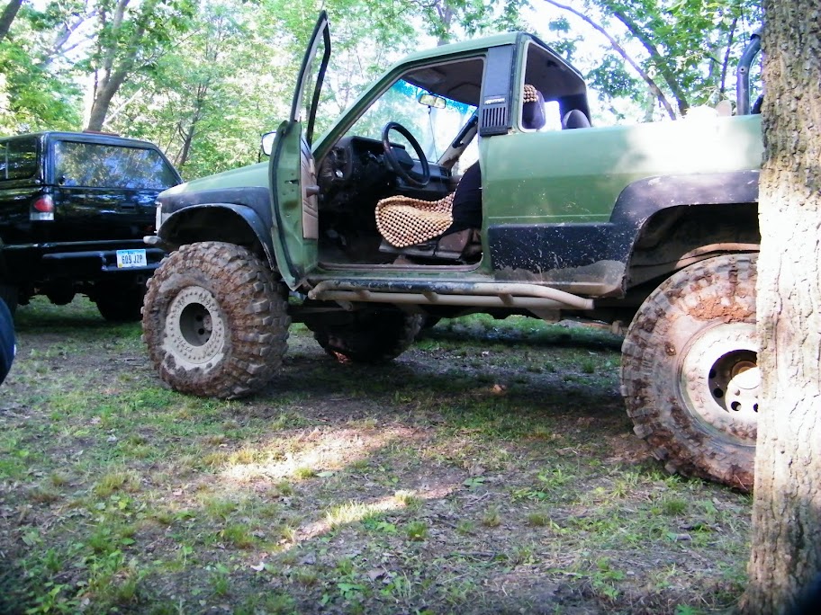

i run an auto meter temp and oil pressure gauge, if you are sure it is not the sending unit, then i would go with an aftermarket gauge, they are not just for looks, they are accurate, and will help keep you from doing major damage to your engine.
here is where i put mine...
that steering wheel is gone, i have the stock Toyota wheel back in now, the adapters on those grants are junk.
