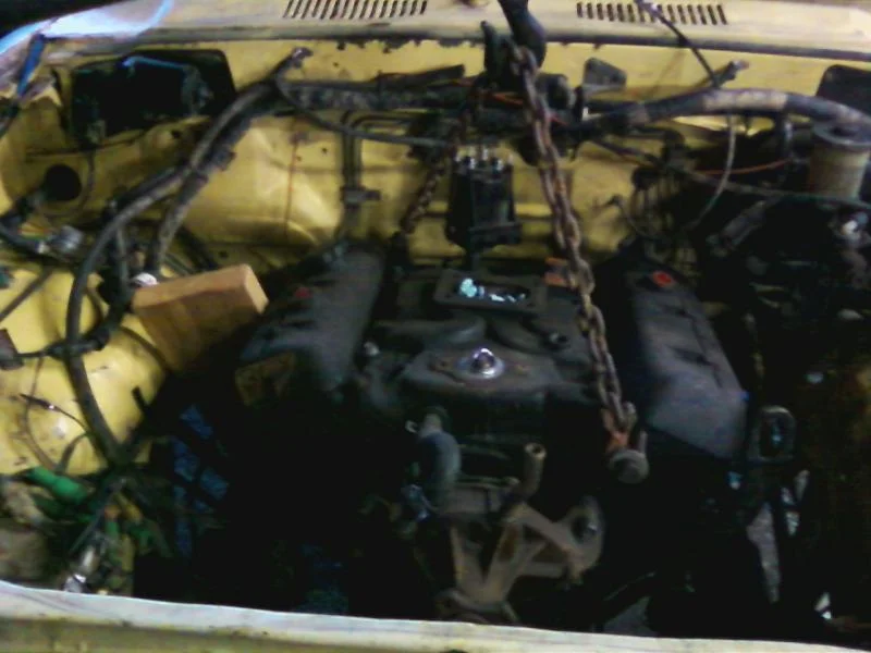

2 bolts away from lifting the 20r tranny and t-case back out. I would say I just officialy threw in the towel for the rest of this mud season. I didnt have much of a choice anyway my throw out bearing was screaming everytime I touched the clutch. I knew this was temporary so I threw in old used parts. It would have been a lesson learned if I wasnt pulling it back out anyway. Don't laugh at the air filter its all I had at the time. Back when I was having MPG problems I borrowed a stock housing and filter and it was no difference.

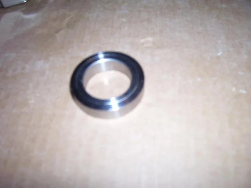

41 dollar pilot reducer showed up today. It wasnt lathed out of gold after all. It is about 3/8-7/16" thick. I would have expected a wider bushing as the extended pilot is probably 1.5" long if I had to guess. They are machined surfaces obviously so it probably isnt a problem and will most likely support the extended pilot in alignment.

The bushing above measures .400 thick with a 1.707 OD and a 1.092 ID. I swung by an acquaintances house that has put the exact same motor in a samurai even though he used and auto and most likely had not been through my challenges. Come to find out he had just pulled the auto and was working on a manual. I was able to share this pilot bearing difference as well as I brought over an appropriate bolt pattern standard 168 externally balanced flywheel and compared it to the flywheel that he had that came with these types of motors and there are a lot of differences. For one the v6 flywheel was way heavier! I had read about that due to torque. We also noticed about a 1/16th of an inch difference in the v6 flywheel being thicker as well as maybe a slight bolt flange backspacing difference. It is definitely going to be a trial and error with a throwout bearing for proper clearance/throw but looks attainable.

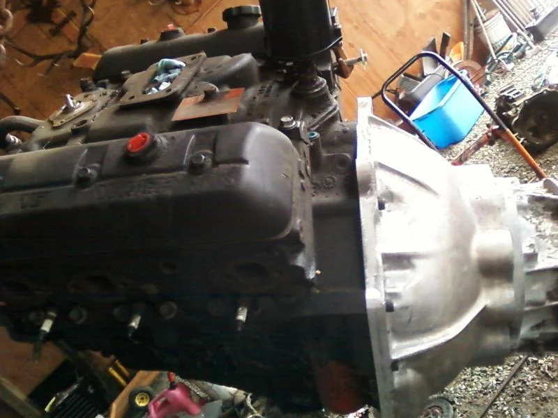

What a difference in weight moving the 20r out of the way and the 4.3 over there...... No clutch or flywheel in there just mocked so I can put it and make mounts. Then I will yank it back out and weld everything up where I can get to it. I had been wondering if the 20r was a tooth off. I pulled the cover and yep the whole time my 20r was a tooth off. Surely the answer to my MPG problems. It ran good a tooth off. Probably would have ran great if it wasnt

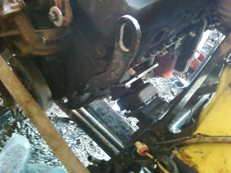

It would fit with the long water pump on it and with a short pump it is going to be fairly decent. The exhaust will be less than fun. I will be amazed if I do not have to do sometype of redneck hood scoop to allow the air filter to clear but I am not willing to drop the motor anymore as I refuse to limit any uptravel due to this swap. The 4.3 motor mounts line up with the factory toyota mounts. I think I am going to be able to adapt to the factory mounts with out it being oakie.

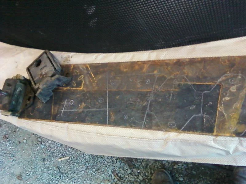

Here is my attempt at that. I traced the factory mounting flanges for both the 4.3 as well as the toyota. Now I will use some poly bushings and tube with a couple tabs. Of course I can only find 3 of the 4 needed poly bushings laying around I am not sold on this idea even though I have cut them out. I may modify the chevy mount to accept the stock toyota rubber motor mount and then chain it down fairly tightly. I do not mind the thought of vibration when I am on it but idling and putting around not so much.
I am trying to get this mocked quickly as I just ran out of spare time. My friend was voted alternate for the top truck challenge so we are ripping his motor out so we can raise it as well as the drive train, installing the Rockwell's, building new wheels, new links, tying up a few loose ends to ensure we can pass the safety inspection, etc. Then after all of that work we will be Hoping he gets a chance to compete

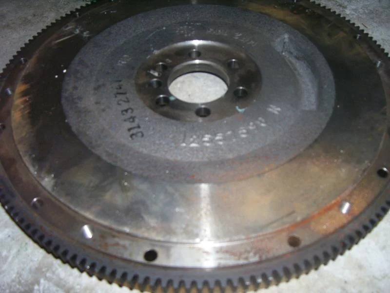

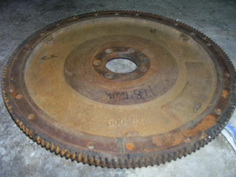

I came home to find the flywheel I needed sitting on my porch. I am very excited and owe that friend a huge favor. As you can see from a distance it looks similar to the standard externally balanced 168 tooth flywheel

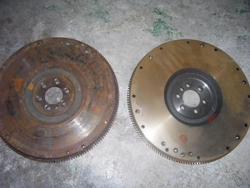

But here is the back of the standard flywheel
Here is the backside of the v6 flwheel you can see how much heavier it is and trust me you can feel it as well. It was intended to increase the torque on the v6s. More importantly the flywheel is in deed about a 1/16 thicker than the regular style.
I am not intending to state the standard one will not work and you MUST get the one that came on them I am only saying I didnt want to take the chance and wouldnt mind the weight in hopes to take an act of congress to pull the life out of the motor with that chunk of flywheel

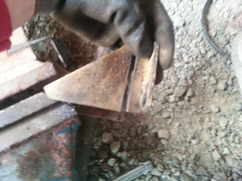

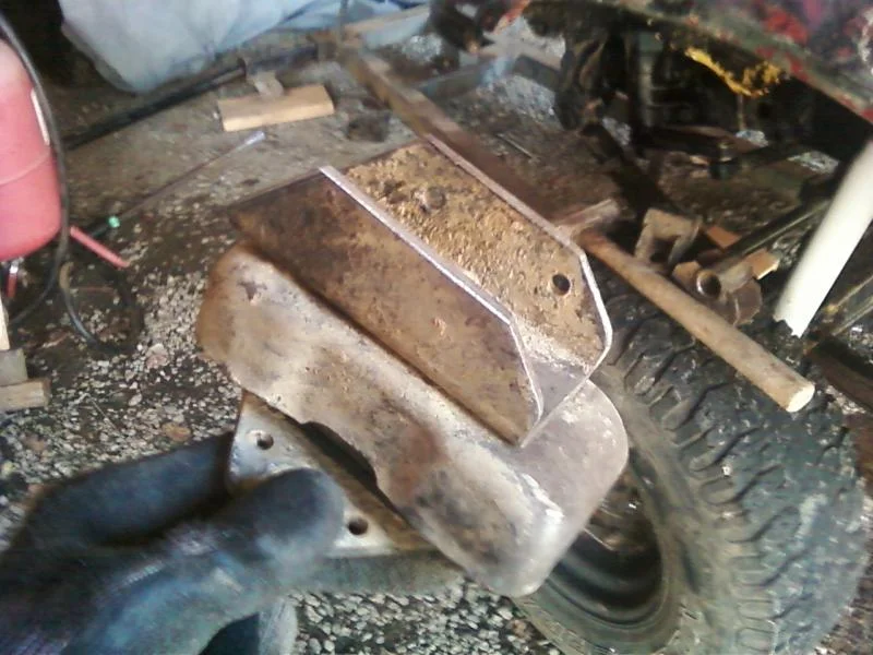

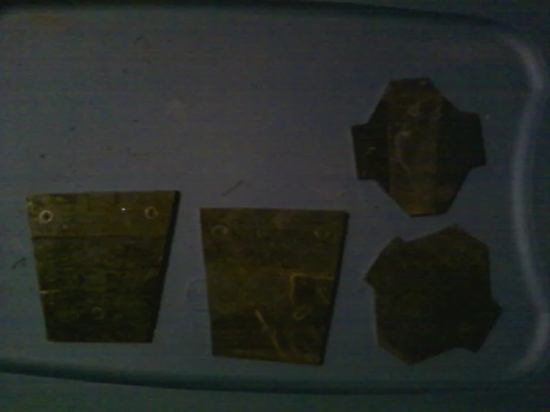

well i am not sure if I stuck to my goal and didnt go ghetto on the mounts but I trimmed the ears off of the stock toyota mounts that mount to the 22r motor as well as cut and drilled motor mount pads for the SBC standard triangle and then just trimmed until I finally got the right fit for both sides. I then welded the factory trimmed toyota piece to the pad I built. It didnt take long and it is solid. I will certainly chain these as toyota mounts are not the strongest in the world but I have not heard of any failing when chained.
I do atleast think I accomplished two of my goals:
1. I shouldnt have vibs due to poly bushings as I was going to use
2. If this doesnt work out I can simply go back to a 22r as I did not have to cut the factory mounts off the frame.
I also cut my crossmember mounts back off and relocated it as well as cut the previous tranny mount off and welded the newer tranny mount on my tube crossmember. So,,,,, At this point the engine tranny and tcase are in. I am almost ready to pull it all back out and weld/clean it up. I just need to check exhaust manifold clearance first

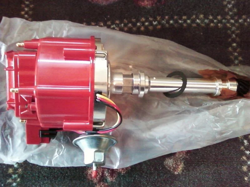

But in the meantime I have ordered some parts. I picked this distributor up on ebay pretty cheap it is suppose to have good juice and a friend has ran one with good luck so far on quality.
