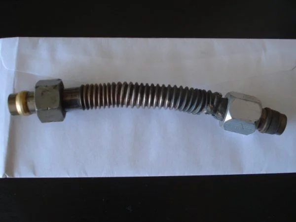

I've had my Downey Headers on for over a year and continuously had problems with the EGR valve flex hose loosening up, over the numerous tightening sequences the flex hose broke. Does anyone know where I can find this flex hose or suggest a fix? This hose go's from the forward fitting on the header to the EGR Valve. I need to get this Runner smogged and this is holding me up.

This is the part I need, not OEM, flex stainless tubing.
