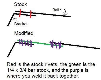

I recently came across a truck where the front brackets on the seat had been drilled out and then a piece of 1/4X3/4 stock was welded to the bottom of the seat rail sticking out to the front and the bracket was welded back on at the front of the metal, thus moving the seat back 2-3 inches. I need to do something about this soon as well....

hey, 2ndGenToyotaFan, if it aint too much of a hassle for ya, if you could post up a pic or two just so i can see what it looks like, czu im gettin really tired of my knees hittin my steerin wheel... but if you cant thats fine

I hope this makes a little more sense.....

awesomeness... that makes a buttload of sense, and looks easy... thanx alot for that image and help, and thanx to everyone else here

Once you do that the rear mounts may need to me modified if they aren't sitting flat on the floor.... Just take a look behind the seat (specifically the side next to the trans tunnel) and see if anything is going to be in the way.
