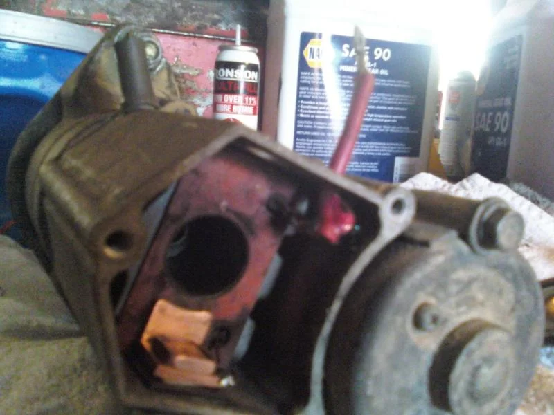

Not much to update, I pulled the starter and cleaned up the contacts inside, then snapped off the plug for the small wire... So now I'll have to rig that back up... I hope I can find some time this weekend to get it a little more water tight, and maybe play with the steering column.

The starter is repaired... I desoldered the broken part, and soldered a heavy wire to it with a regular spade connector on it going out through the hole. The stock plug should go right on it. Then I used The Right Stuff to make it stay put and not ground out anywhere, and seal up the hole. See fuzzy phone pic. Going to try to get to my dad's today and steal his spare steering column.
