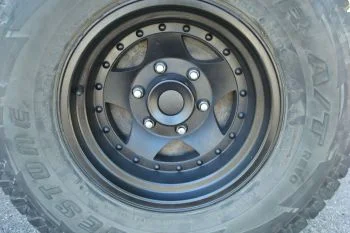

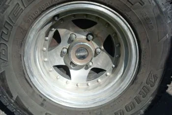

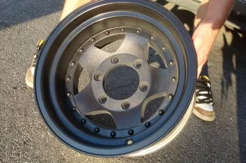

So I was going to get a new set of wheels, started thinking about it I would be replacing my 15x10 inch alum wheels with steel ones the same size, I elected to put some work into refinishing my old ones. I sand blasted each one then painted and put clear coat on and these are the results. Did I mention from start to finish it took me 3 hours or so a wheel?

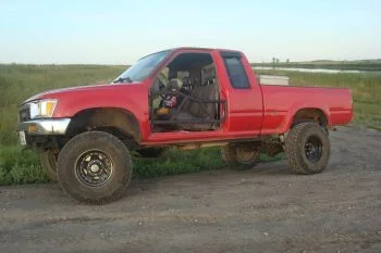

I have been doing alot with my truck lately you can see in the picture above, mud flaps are gone, rear bumper gone ready for a steel replacement, diff drop, tore the carpet out to be replaced by undercoating but am still deciding what undercoating to go with. Any suggestions? Anyway let me know what you think!

Garage
Good results man, they look brand new
What kind of paint and did you primer?

I used a flat black VHT header paint no primer 2 clear coats. I chose not to primer because I still wanted that textured look. It is tough, I will see how it holds up to a North Dakota Winter!
