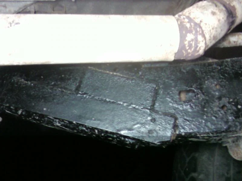

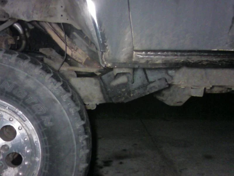

the first one is the drivers side inner frame... second one is the passanger side outer.. and the third is drivers side

kinda scary lookin at first... had to scratch my head and wonder if itll actually hold and drive down the road straight... and with two somewhat long trips, one about 500 round trip and another about 300 round trip... only thing that went bad was the rear u-joint... otherwise its fine

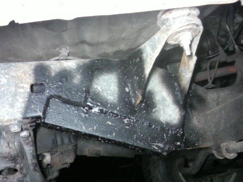

any who, i just looked at the passenger side and theres an even bigger weld on the big nut...

All the more reason to get new spindles.... There is supposed to be 2 big nuts that you tighten together with a locking washer, not tack welds holding your tire on. If those welds fail, it's going to be a bad time, and someone could get hurt or worse. Please change them as soon as you can!!!

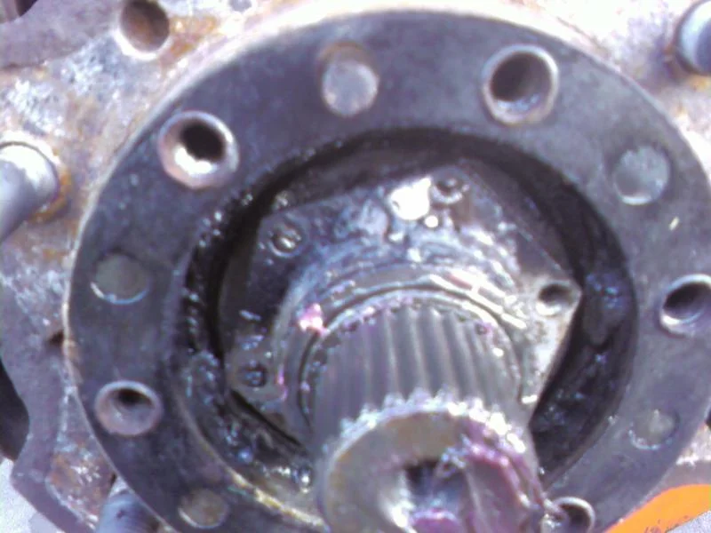

welded nut...

Ah.... that's the single nut that is used on trucks with auto locking hubs, someone swapped to manuals and didn't pony up to get the right hardware to do the swap... and without the auto hub, that nut will not stay tight, so they welded it.... I guess it's not going to come off though is it... Looks welded pretty good. Scary none the less...

yea it does look pretty scary... but its an 87 tho... i thought auto hubs started out on trucks from the early 90's, not the late 80's... i mean correct me if im wrong

Pretty sure a lot of the late 80's 4Runners had them........ a luxury for the runners? I don't recall seeing a lot of older pickups with them.

yes it does have manual hubs... and thanx for the help... im gonna write this down and keep it safe in the trucks center console.. and if theres anymore parts not listed here please let me know
I think that is everything you will need minus all the hardware you already have on the hub.
You will probably want a brass punch or hammer also to get the cone washers out of the hub.
This will get you most of the way there Toyota 4WD Front-end Maintenance - Disassembly - ORN

i have a lead hammer, idk... the cone washers actually come out on their own... and i actually need a new gear thing... sorry for my lame attempt with names... but its the one piece inside the hub that stays in place on the half shaft, that sits and stays in the hub.. and sorry for bein a pain, but i wanna get this done right you know...now as for the gear piece... where should i go to find one of them?? again sorry for tryin to discribe things and somewhat failing... and i will certainly look thru that fsm quite a few times
