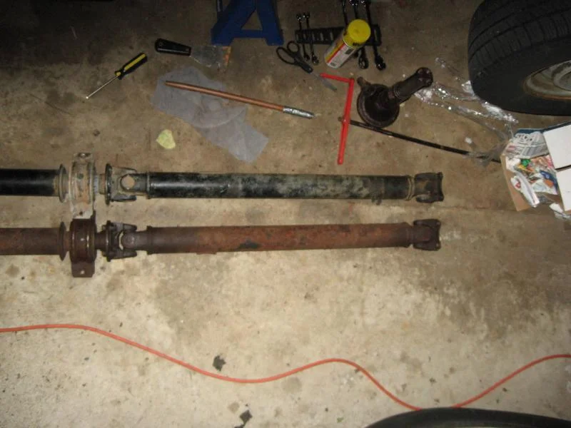

not for nothin but try and get a photo of the two drive lines next to eachother and point out what is short. If I follow correctly your saying that the section of drive shaft with the carrier bearing is just s smidge too short for the pillow block bearing to mount up correctly. If this is the case then there is a discrepancy in parts. If im speaking correctly get an exact length of what you need, Maybe I or someone else has one that you could get for the cost of shipping.

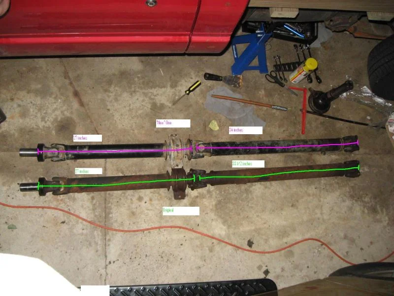

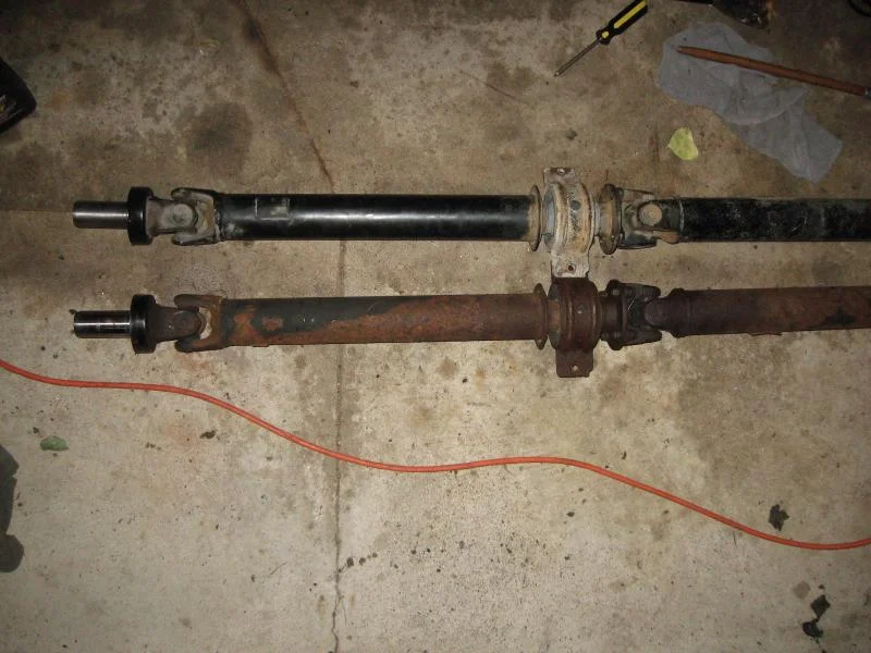

new pics, lengths, update
Thanks for the responses guys. I took both shafts and laid them side by side. At first glance they appear to be exactly the same until I took the measuring tape to them. The front half of the shaft is EXACTLY the same length, but the rear part of the shaft is exactly 1/2 inch longer than my original one. I find it hard to believe that they'd make an entirely different shaft that was exactly the same in every way except 1/2 of 1 inch?
My truck is an 87 2wd automatic, fuel injected, with overdrive. The replacement shaft is supposedly out of an 84 2wd fuel injected truck.
What are my options now? Is there a way to cheat that half inch somehow to make the carrier bearing line up? Remember it is 2wd so theres no slip fitting on the rear half of the shaft. The original intent was to replace the rear U joint and the "yoke?" (still learning terminology ; ) as it is badly badly worn. The joints on the replacement shaft are all in good condition and don't really need replacing. What do I do now guys? Sorry if this is all elementary to most of you, just learning as I go here.
Thanks for the help guys and Dr. Cheeseburger for taking my call
Matt

once I uploaded it it's hard to see the numbers for my measurements. Both the front halves measured in at 27 inches. The replacement one, rear section, from the points I marked, is 34 inches. On my original from the same points that I marked it is 33 1/2 inches.
Howdy! If the rusty one has a bad yoke on the diff end, and since you already have the nicer one, find a driveshaft shop and see how much for a cut and balance. Brobably less than another shaft. The carrier bearing is press fit onto the shaft, so you can't really bump it to fit. If you did retro-fit the mounting bracket, it might fit, but then the front section may still be 1/2" too long when it is pushed into the transmission. I suppose you could trim that off with a hacksaw. John

Ya depending on what part is really messed up I would put the new front section in and temporarily run the old rear section while you take the replacement to a driveline shop and have it cut down that 1/2 inch and rebalanced.
Could be that your u joints are to the point where its dangerous to use the old rear shaft, but if you get new u joints for the old rear shaft, theirs no reason you cant swap em into the new rear section after its cut down. But thats a lot of work and if i could squeeze out a couple more weeks on the old shaft's u joints while this stuff is happening i would.

The rear yoke is the part that is really worn. Prior to removing the old shaft it would sound like the entire shaft was gonna spit out the back. Worst vibration and metal on metal noise I've heard. Obviously waited to long to address this problem but I guess thats how I learn.
I called a driveline shop and he said he could cut and balance it for $65. Is that a fair price?
