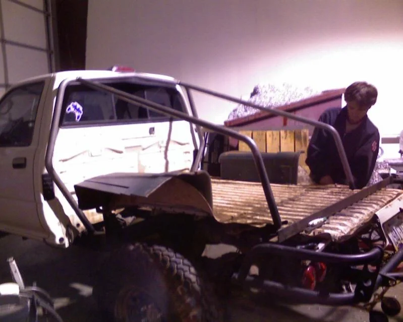

I wanted to keep the bed at first but a rear end collision bent things up pretty good. Happened three days after I had a practical hinged gate mount for my sandladders. I started making another variation of the hinged mount that ended up failing. The straps hold the gate well enough for now until I make something right. I can still cram bikes in the bed, just gotta ditch a spare. I'd rather keep them both, if I need one I swap them both for the dang offset. Getting spare wheels for my 10.50's when tires happen.
The rear shocks are smaller Bilstein 7100's. I thought I could get away with lighter shocks in the back but I've bottomed out back there lately. Rear springs came with the truck, appear to be Rancho's .

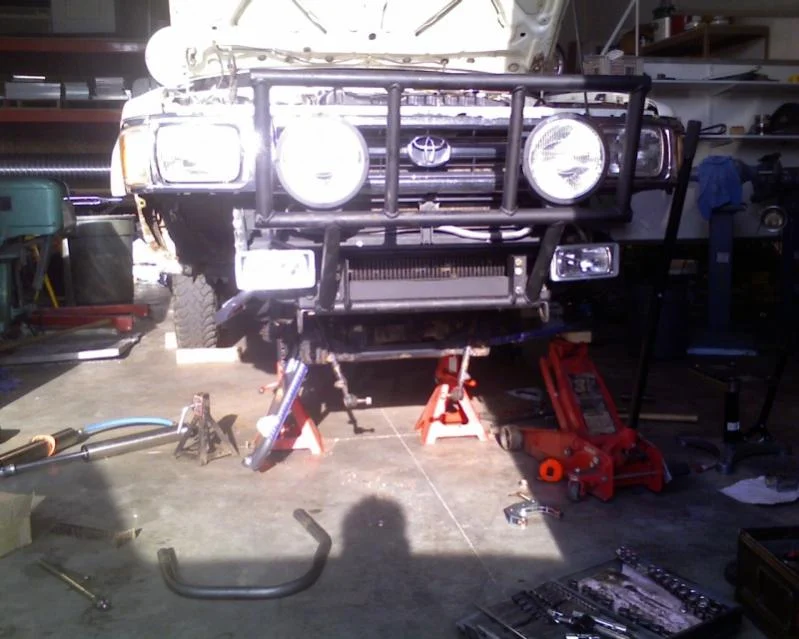

Nothing special under the hood (literally ), stock 3.0 with Mr. T gaskets, DOA head stud's and a Flex-A-Lite fan. I dig the fan in the summer but it sucks in the winter and at water crossings (they're sharp for maintenance too). Gets consistent 20 fwy/18 cty and runs, that's all it needs to do for now. Gathering small 3.4 parts but a swap won't be practical until I have a garage again.
The cow catcher's lower rectangle is .250 DOM with mounts to an ORS Frame Crossmember. Upper tubes are .125, the rest was left until I figured out how wide the truck would get. Welding is at a standstill for now, welding buddy slashed an index finger tendon. It's fixed now but recovering, I'm getting better but need practice.
You can't see it in this picture but I've got some gouges from sliding over rocks and a dent in the passenger LC arm. The gouges were gentle but I remember the rock dent, that was a big hit.

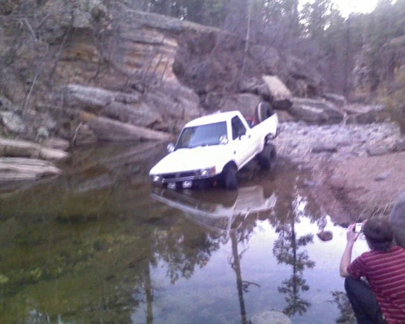

Current front end wheeling, wasn't able to make it this high up the hills before:
This one sucks, got really up there on a slope. I could see the Grand Canyon from this slope, however this is where I realize the camera focus is damaged.
