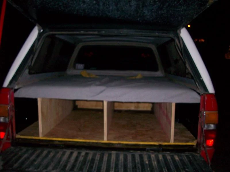

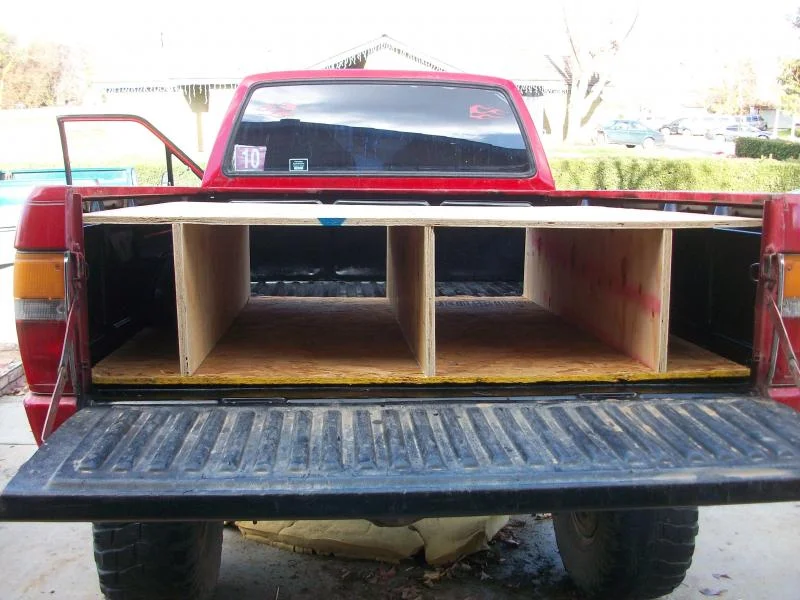

I want to keep the bed, and build a drawer system like in the back of a LC. Also I am going to put a tool box in the bed.

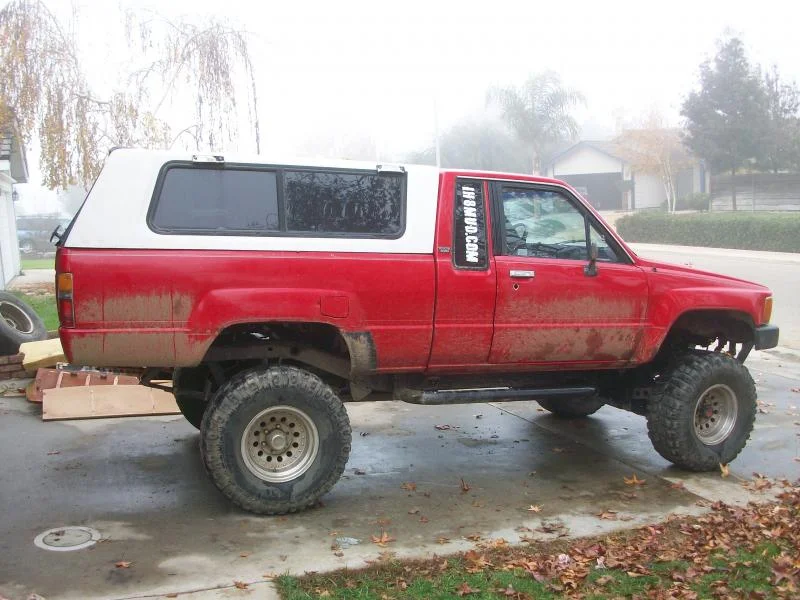

He already has the lift...
...any pics of expedition minis?

Decided not to bob the bed, and I got a newer camper shell that fits like a glove. The shell also has built in brackets for a roof rack! Got rid of the low hanging rear bumper. Built a drawer system for the rear (not finished yet), and replacing the engine within the next week or so. Busy busy...............
