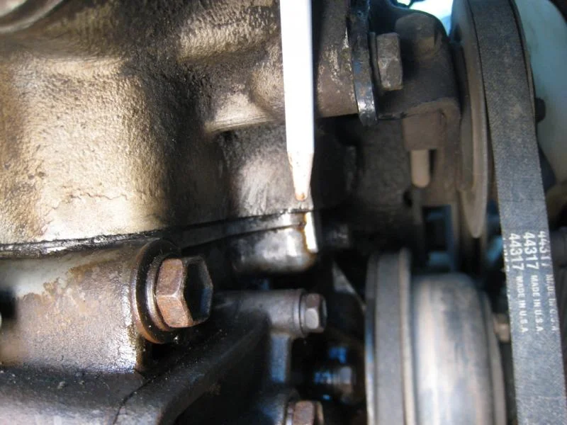

ok guys cleaned up the engine good and actually was surprised what I found... not coming from the timing cover at all seems like it is coming from the head here... see where the pencil is pointing... please please tell me I dont need a head gasket???

Posts: 1,204
Quote:
1: Try and tighten the hidden bolt under the distributor drive gear.
2: The gasket looks mighty thin there so, I believe it won't work...but wonders never cease.
3: If all else fails you could try to run a stop leak in the oil...and as much as I H8 to say it, and you don't want to pull the head, it might work out for you.
4: You could be on your 4th engine removal, I'd be happy to have to just remove the head if I were you...(have the head redone. That will also help with oil consumption and will add life to the head. New HG means "New top end" PM, IIRC)
5: Looks like the TC has been pulled. That can tear the HG material sometimes.
you could try and tighten the hidden bolt. it wont do much good if its already good and tight. but if it is loose perhaps it will allow the leak.
you know which bolt i mean? under the distributor shaft...
otherwise, the gasket needs to be replaced.

Why not pull the TC cover and FIPG a bit?
There are no pressure issues to be concerned with right?
Am I missing something?

Quote:
this is what I was thinking of doing... I know it might be a hack... but if I can get by for a while... I would... what does everyone think???

do it.
Just a tot, but aint his truck IFS?
If so, wouldn't it be easier to pull the head? Instead of the pan?
And for the life of me, I can't figure out how you would apply the FIPG in order for it properly seal (that area) once you pushed the TC cover back on.

Well, first off, you don't have to pull the pan. You have to lower the pan enough to get the TC cover off.
I am not sure how you don't understand about the FIPG. I didn't and many others have not removed the head to do the timing chain. I placed FIPG on the top of the TC cover which matches the head and all I had to do is make sure the head gasket did not bend back when putting the TC cover back on.
0 issues and I have no leaks.
Now, my head gasket is original. 175k miles. I can't imagine his is in any worse shape.
