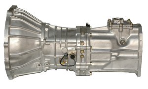

this is a G54. this uses a forward shift transfer case.
this is a W56A. this uses a top shift transfer case.
look at the VIN plaque. on the drivers door jam. it is white, and square. has black lettering.
Look for the trans code. you probaly have a W56. check out that link i gave you and look at every single year range of transmissions. get familiar with the codes. use this knowledge to find the code printed on the VIN plaque.
W56 series use both top and forward shifting setups.
if you install a top shift in place of where you had a forward shift you may have to cut the floor and get new boots.
swapping handles will do you no good.
