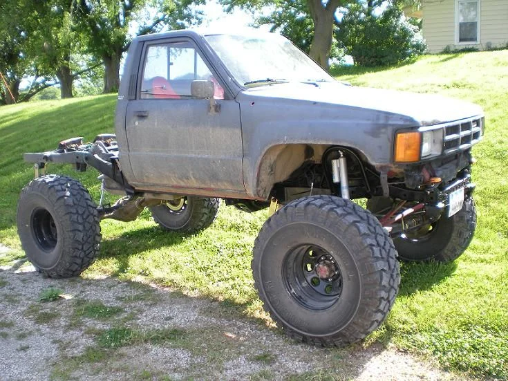

Thought I'd post a pic of my truck

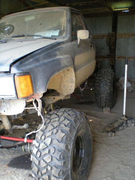

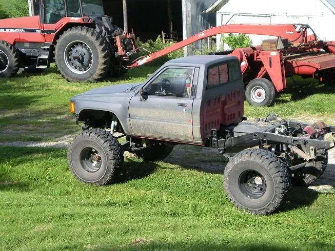

This is my '86...just finished the sas, these pictures are and night before we got it all buttoned up so it's being broke in right now. I'll get some more after the body lift is out (hopefully this weekend) and the bed is back on.

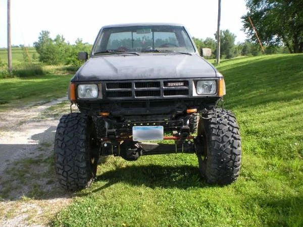

sweeet!
those pitbull's? why'd you paint yer tie rod red? __________________ Wristy check the FAQ! 1980 RN37 ![]() ![]() 1989 RN101 1986 RN64 Quote:

Posts: 147
That is one really tall truck, how much lift did you use?

He said it had a body lift also. Probably a 3" from the looks of it.

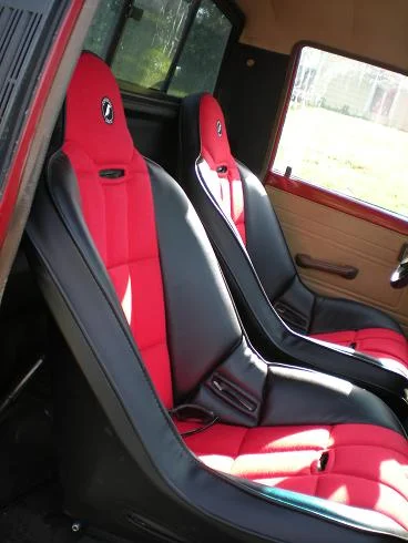

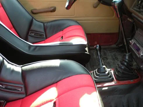

The seats have a red inset and the ring around my shifter boots has been red so I figured maybe continue just a little outside of the cab. The body lift is a 3" but should be gone after this weekend hopefully. 6" springs, 37" Pitbulls (love em), 5.29's, rear discs, axle armor all around,....until some more $$ comes in there probably won't be many new parts for awhile. I've been collecting them up for about 8 months so I could do most everything underneath except for my dual case, which will be quite awhile yet. I'm still waiting on the front driveshaft too. I also undercoated the inside of the cab all the way up to the headliner, I'll get under the dash later when I get rid of it and flat panel it. Even just a light coating of that stuff is sooooo much quieter than what it was, probably keep the heat in the winter better too.

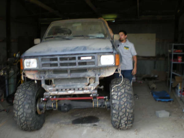

Got the body lift out and the frame cleaned up and sprayed....hopefully the bed will get back on this week sometime. I've been watching your thread WristPpin and I like the way you've beefed your frame, but mine is pretty solid and I dont get to see as severe wheeling as a lot of people on this forum. I went a little overkill on the truck as far as what I needed, but I figure hey...I don't get to take the money with me later so I might as well spend it on toys now. Lol.

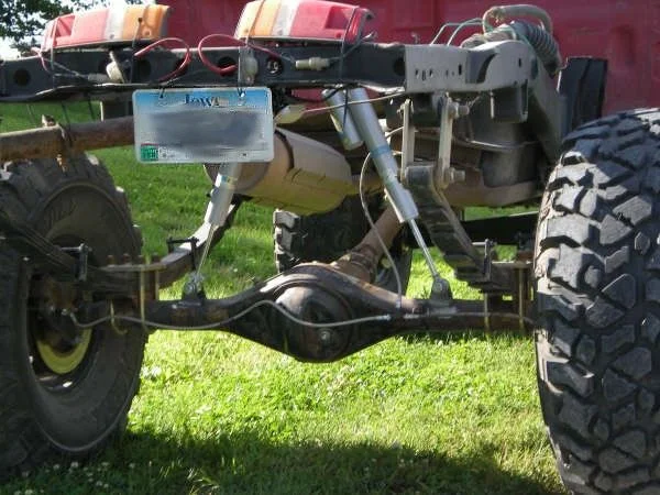

Posts: 90
Did you gusset that front spring hangar? Looks like its not fully welded on
#19 |
IH8MUD Rookie
Join Date: May 2008
Location: Iowa
Posts: 35
Yes, gussets are being welded on today actually, and no it isn't fully welded all the way around. Both ends are solid and there are a few added since the first pics...front and backside. I also made me a plate out of 1/4 steel to reinforce the front bumper mount, similar the the FROR bracket, which will be welded up and fill in any areas that we didnt fill already.

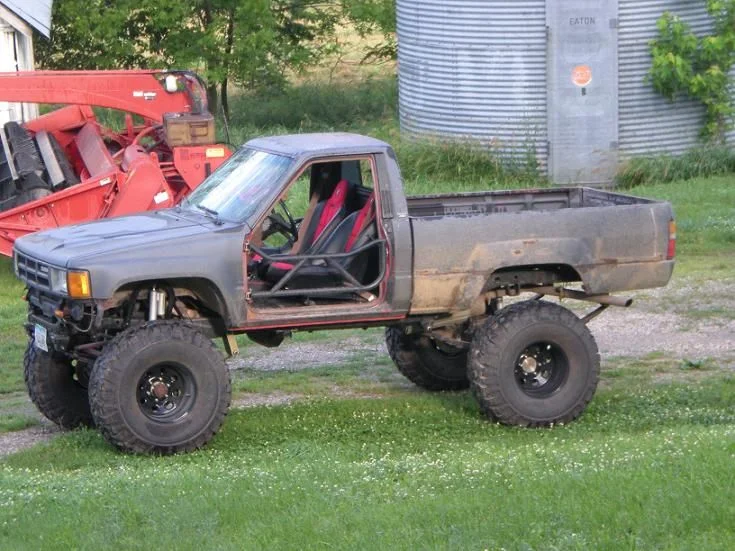

Just a couple others....

Who makes those half doors??
#28 |
IH8MUD Rookie
Join Date: May 2008
Location: Iowa
Posts: 35
You can get those from 4xinnovations.com or WabFab.org I believe. Its fun to ride around without doors, gets a lot of stares too. Thats half the fun is just seeing people drool over an old Toyota pickup that people dont seem to think is worth anything anymore.

I noticed that in your pictures, the 7150 & the swather aren't moving, did your hay get rained out?
#30 |
IH8MUD Rookie
Join Date: May 2008
Location: Iowa
Posts: 35
Yeah, those dont belong to me. My property ends on the outside of the driveway, those belong to the farmer who owns the land surrounding mine. He doesnt get into too much hurry, the field to the front of the tractor will usually have corn in it until end of January or mid February. He is rich as hell and hunts so he likes to bring the deer to his property, so he just wastes this small field. But yes, there for about 3 weeks it was like rain every day or every other day. Places all over got flooded, roads closed for several days, interstate for a couple days, who knows how many basements full.
